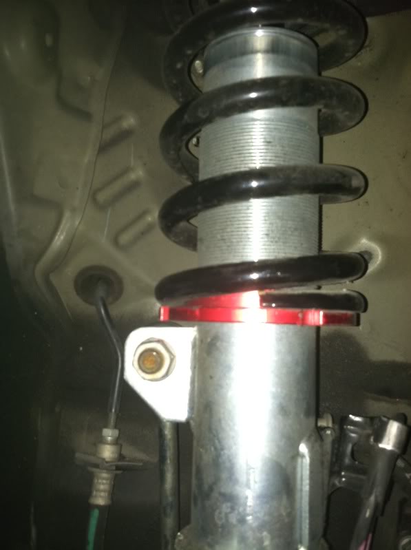

i was adjusting my front camber today again cuz i noticed my front right was still toooo close to the fender. i couldnt figure it out why it was like that cuz i maxed out both camber bolts already. then i figured it out. i was looking at my coilovers, and i noticed the left side was sitting a little bit lower than the right, making the tire too close to the fender. i compaired both sides and the right side was like 2 treads higher.
this is the right side. you can see that i only have the top ring since i removed the bottom locking ring. if you look close enough, u can see that the metal piece where the sway bar is connected to has a small weld that prevents the ring to go all the way down.
this is the left side with the ring all the way down so its touching the sway bar holder thing. so it was like 2 or 3 treads lower than the right.
so since i couldnt lower the right side anymore, sadly , i had no choice but to raise the left side to match the height of the right. so i used a nickle and a penny to measure exactly how much higher it was than the other side.
and i matched that with the left side.
so now, with the wheels back on, the tires are still mad tucking, but i have about a 2 1/2 finger gap in both fronts, and a 1 1/2 finger gap in the rears. the rears still have about 5 treads left, but i dont wanna go any lower back there or it would look retardedly uneven.

So the right perch was just sitting on that holder thing?

yeah, but u can see the ring is a lil bit tall. so it was still on the treads. just at the lowest setting. me and Socal are doing the same thing with our coils. its the rears that are sketchy cuz if you put the rings too low, it will literally fall right off the strut.

That sucks though man. I'd say shave off the part that's not letting it go down... But its a weld, no bueno. Whenever I get my camber bolts in, I wanna try shaving my bumpstops. Wanna go mad low in the front.
