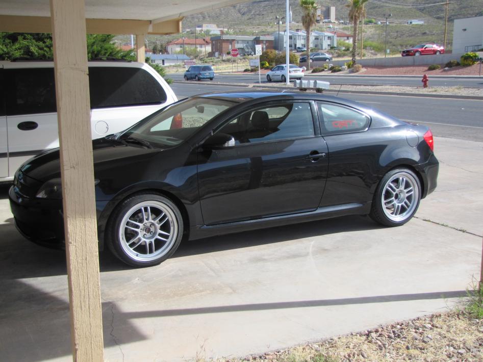

Hello everyone, Ive decided to finally post the progress of my build, as well as a link to my "FundAnything" build page in case people want to get in on the action.
I'm going to give a detailed list of my current upgrades, as well as some pics, and also a list of future upgrades. If you have any input or want to contribute, please visit my page and let me know. Also if you happen to know of a crackhead deal on some of the parts I don't have yet, feel free to bring them to my attention!
For starters: here is my project page:
http://fundanything.com/en/campaigns/project-scion-tc
Next up I'm going to give a detailed list of the parts I have and the parts I need. The parts I have are in BLUE and the parts I don't have but still need to get are in RED.

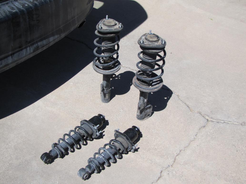

Hey again! I'm always glad to answer questions so here goes:
I like the TRD struts/springs, they are huge improvement over stock, and honestly I didn't need the adjustability either, I just wanted a good ride height in addition to better handling. They drop the car about 1.25" which is perfect and doesn't require any camber/caster kits or adjustments, although you might want to get an alignment after you drive them the first 100 miles and have given them time to "settle." Usually, trdsparks has the best price on these:
http://trdsparks.com/displayparts.ph...1&parts_id=586
They are perfect for a daily driver and for the car that occasionally sees track time. Although I will say I'll probably get the TRD Coilovers when it comes time to change them out again, but by then I'll have another daily driver and this will be a dedicated track car so I'll actually use the additional stiffness.
Get the Ingalls 4point rear strut brace, especially if you can get it for $90! This is my absolute favorite suspension mod on the entire car. In stock form the TC has a ton of body roll and this brace gets rid of a lot of it. It really keeps the rear end flat thru the corners and it let's me feel way more confident about pushing the car. If anyone tells you it isn't worth the money, it's probably because they never really push their car with spirited driving, or they are just driving in a straight line so they don't notice the benefit. Granted, this mod works even better for me because Ive got the TRD shocks/springs, as well as wider/stickier tires, but you will absolutely see a major improvement thru the curves even if the rest of the car is stock.
As far as the front sway bar goes, I'm a big fan of this as well, but only if you have a decent amount of driving experience. Your average front wheel drive passenger vehicle (chevy cavalier, nissan altima, ford taurus, buick regal etc) is designed from the factory to understeer because it's a lot safer in normal traffic conditions, especially for your average soccer mom who is going to slam on the brakes and cut the wheel to avoid a wreck or some other road hazard. You don't want Grandma going into an oversteer spin if she is trying to avoid a squirrel lol.
With that being said, a performance car driver or even just a mediocre enthusiast who knows what to do and isn't afraid of man-handling a car typically hates understeer, and prefers a little bit of oversteer because it's necessary to take a corner properly.
The Scion TC has so much understeer in stock form, that even with the front sway bar, front strut brace, and wider tires it still understeers some, so yes I do tug on the e-brake a little bit in certain circumstances.
But the front sway does give the car much sharper initial turn-in. I view this mod as absolutely necessary to get decent handling out of the car, although if you are getting mods one at a time, get the Ingalls rear brace first.
