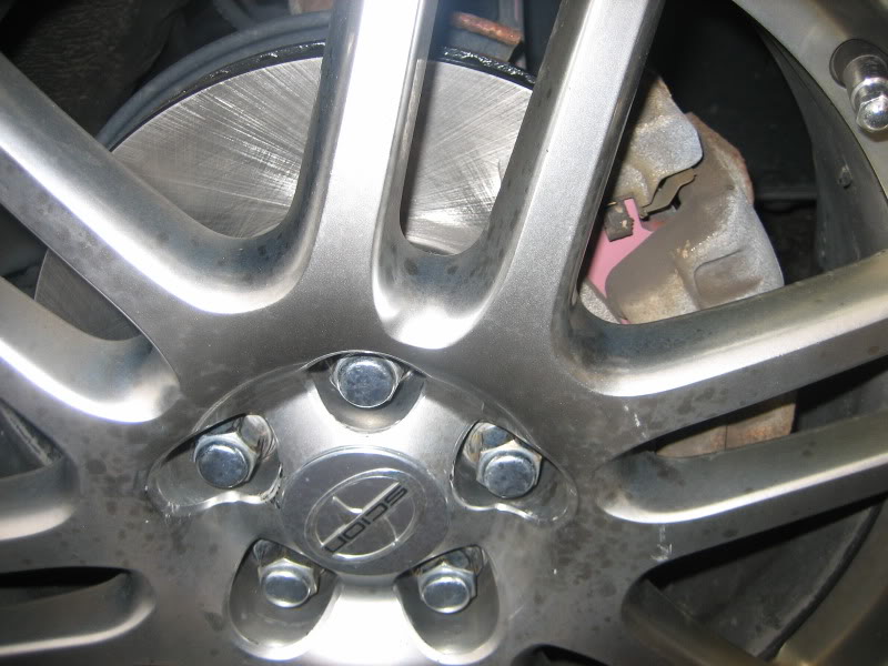

Hi guys. Here is the final result yesterday after taking it to Monro Muffler. Was surprised they were able to do it so fast. Probably because I loosened all the bolts except those 16mm ones. They probably could get more leverage from being under the car. I was using a 12" wrench and even though I'm pretty strong, couldn't do it.
The rotors are nice. If you are wondering why the pads don't have the metal bracket around them like in the DIY, well those if they ever were there, melted into the old pads that were almost 4 years old after several winter storms later. The mechanic said I might hear clicking but I don't care. I haven't heard anything yet. The brakes are a huge improvement! I can now stop on a dime.
I plan to replace the pads myself next time since they are easy. I will have the rear rotors/pads replaced later in May just so everything is the same. I will buy the parts and have a friend do the labor. I will only use the jack for replacing front pads and rotors. Not messing with e-brake haha.
