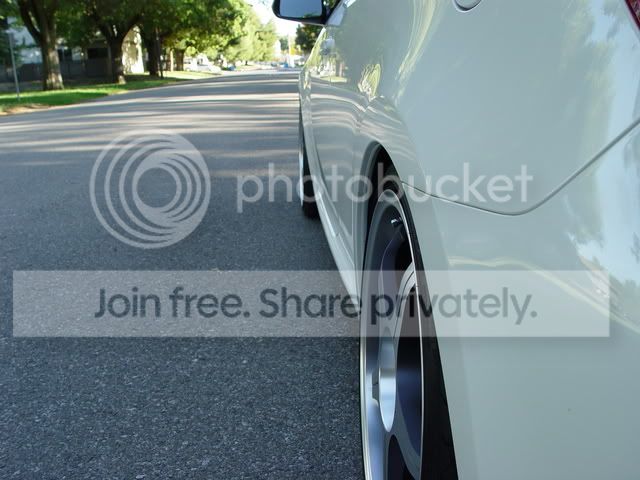

What is the offset of your wheels? That will have a lot to do with your clearance issues. Also do not waiste your money on the TRD Struts as they are not made for such an extreme drop, they will probably go bad just as quickly as the stock ones. I think there might be some rubbing with 8.5 wide and such a drop, specially when steering. Again your offset will make or break the deal!!
Just so you have an idea, my car is dropped with the Hotchkis springs and that is just under two inches. I am running 19x8 with 35mm offset, tire size 225/35/19. I do not have any problems with this setup, steering lock to lock is perfect. No rubbing in the rear at all. In the front when going at high speed(around 80mph)sometimes if there is a dip on the road i will hear some rubbing. I atribute this to the factory struts being too soft for the drop and the speed. This has only happened a few times and is not a mayor concern as roads around here are very good for a change, but will change my strut as soon as something nice is available. Check it out!

looks good. tires are 225/35zr19 so i think i would rub... plus i have major speed bumps in my neighrbood. i think im just gonna wait for the b&g coilovers to come out... which might be a few more months. im too worried aobut rubbing, and i oly want about a 1.25" drop. so i got free springs... but not gonna use em... oh well
