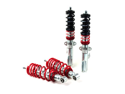

For 3 months I researched different suspension components in hopes of getting the tC to handle better according to my driving skill and preferences. My plan was to install TRD shocks with H&R Sport springs until I did the math (parts and install time) and figured for a little bit more money, I could go with H&R coilovers. Originally I was against the idea of installing coilovers, after all, my car is a daily driver and may see a race track once or twice during my ownership. However, when I got a great deal at All Springs.com (Turner Motorsport), I quickly changed my mind. I was thinking I would give it a try and if didn't like them, I could purchase TRD shocks and H&R springs and put the coilovers up for sale in the classifieds... luckily, I won't have to.
Installation
I had Josh at FasterScions.com do the install. Since he specializes in Scions (obviously) and owns a tC, I figured he would be able to do the install in about 3 hours and do it right... he did it in under 2. Since the front coilovers came assembled and only needed a few of the original parts for mounting, it made his day, and most importantly, it got me on the street a lot quicker.
Ride Quality
I've never driven a car with coilovers and most of what I've read/heard about them is how hard the ride is. Because H&R doesn't publish their spring rates, I had no idea what to expect short of a few comments from Joe Dezod and others. When combined with a TRD sway bar set to "Race/Track" (and stock RE92 tires), the ride is stiff yet controllable and not uncomfortable. After changing the sway bar to "Street", the ride quality improved greatly and made it feel very similar to the TRD shocks/springs/sway bar [Race] combo with a touch more road feedback. I feel the latter setup is best for daily driving, so I'll leave the "Race" setting on the sway bar for the track.
Handling
Even with the stock tires, handling is vastly superior over OE. Body roll is negligible on the street, the wheels stay planted over bumps, and steering is neutral. Despite my best efforts, I have yet to find the limits of this suspension on the streets without resorting to extreme stupidity and endangering the general public and myself. Conversely, when others act foolish, emergency handling is razor sharp and kept me out of path of a [presumably] drunken SUV driver in the next lane. After some experimentation, 1.75" drop in the front and 1.5" drop in the back seems to be an optimum setting (and looks nice IMO), and as expected, steering response has improved and should be even better once I get a four-wheel alignment.
Thanks to Josh at FasterScions.com, Joe Dezod, H&R Springs, and Turner Motorsport for their help and professionalism.
