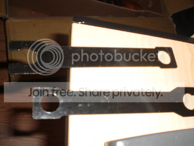

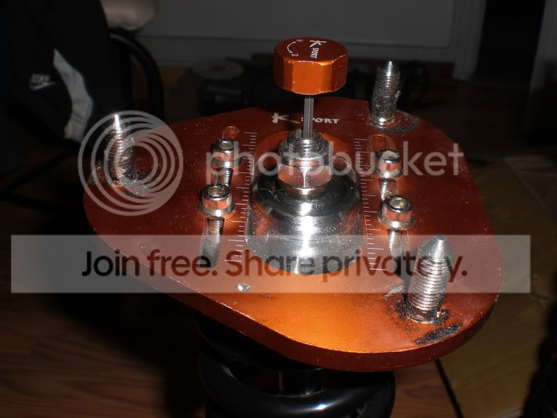

Hey, what are these for??
and another question is whern I try to adjust the Dampening adjuster for one of the front coilovers it just spins and does not do anything. The base is loose compared to the other one. Does anyone know what may be the problem?? And what is the purpse for those 4 nuts??

those black strips are to replace your brake line brackets....
those four bolts are for "camber adjustment" they dont really mean anything....just set them a lil negative and then go to alignment shop...dial them in to equal...then get your toe aligned...carve some corners...

Is it vital to install those black things and is it easy? Is it for the front? How soon after i install them should i get an alignment? So everytime I lower it or raise it I have to get it aligned? If so that sux...al lot of money.

From: Birmingham
honestly yes...but they are easy....i didnt receive those so i had to fab up some...uh depends on how much you plan on varying the height...if you adjust it 1 or less then i wouldnt worry about it...probly could get away with 1.2" without it...but trust me just spend the time while installing and pick a heighth you like then drive around...raise a lil if you have to then go get aligned...and leave it...the more you fiddle with the better the chance of ____ing stuff up....(from a handling dynamic point of view)

One more question how do you adjust these bad boys can you give me a run down on what does what. Thanks
blackcherry07, I also pmed you..
