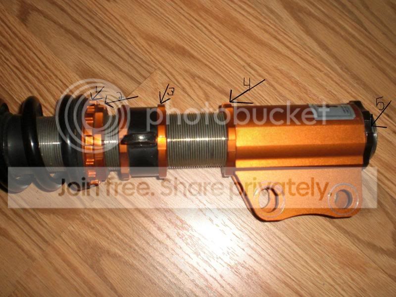

sure...
front:
1. Pre-load collar- just tighten this until its snug
2. Pre-load locking collar- tighten this against the pre-load collar to keep it from loosening itself
3. Sway bar mount and locking collars- adjust this to get the sway bar in the right place, then lock down with the collars against eachother.
4. is a locking collar for heighth adjustment.
Between 4&5. Heighth adjustment- this will be what will adjust the heighth
5. locking collar for heighth. tighten 5&4 against eachother

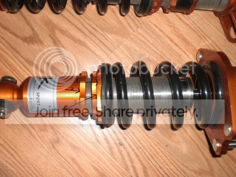

BACK:
1. Pre-load- same as front
2. Heighth locking collar- tighten against the bottom piece
3. pre-load locking collar- same as front
now that bottom piece is what will adjust the rear heighth.
my advice...take your tools and kind of play around with them to figure out which ones lock against eachother and whic ones adjust stuff...

also yu probably shouldnt even have to touch the top most collars....(1 &2 on front 1&3 on rear...)
