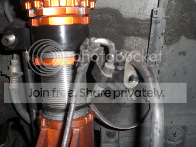

This is the burnt rubber I was smelling.....
My rim was eating away at my the line. I guess I did not do a good job of securing my lines. Do you think I can patch it up with electrical tape or am I gonna have to get it replaced??
Old Feb 27, 2009 | 12:40 PM
  #112
teamben158's Avatar
Posts: 909
Clean it up and tape it.

blackcherry07's Avatar
Posts: 528
From: Birmingham
yea just tape and you will be fine...and use a ziptie to secure it up top where the endlink mount is

dqlostsoulz's Avatar
Posts: 4,716
From: Californication
Thanks, can I zip tie it lower by the lowering/ raising mount?
Posts: 4,716
My abs light is on know any ideas how to turn it off??
Old Feb 27, 2009 | 06:59 PM
  #116
Posts: 528
From: Birmingham
that may have to do with what you rubbed....was it a wire?? did it rub through the wire??
Old Feb 27, 2009 | 07:01 PM
  #117
Posts: 4,716
Yes but I taped it...any idea what to do??
Old Feb 27, 2009 | 07:19 PM
  #118
Posts: 528
From: Birmingham
like you need to make sure the wire is still intact on the inside b/c i think that is your ABS sensor and it is reading nothing...
