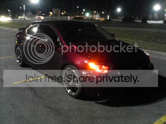

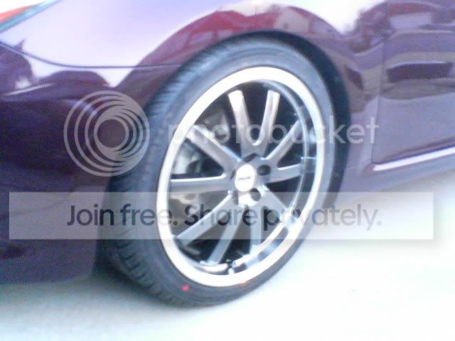

Ok with my offset (35) and Tein H techs, I do scrub a very little bit on some bumps or very hard left turns.
These are camera phone pics, I'll get better ones soon...
