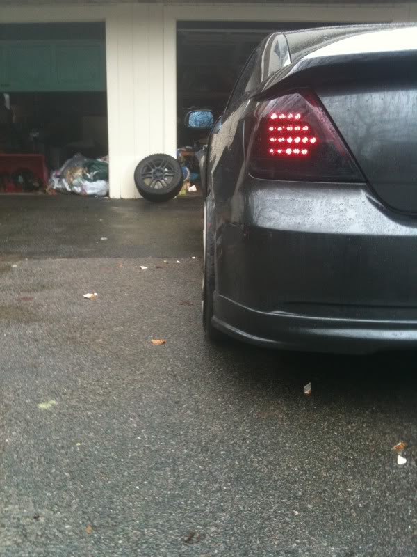

oppposite, the lower the offset the further out the wheel is, for example...
18x9 et 16
see how far past the fender it is. your wheel would be about 25-28mm more in then my wheel set up (18x8.5 et 38 vs 18x9 et 16 using approximately 5-8mm to compensate for width.... correct me if im wrong on that)
but my set up is a little more aggressive then what some people would feel comfortable going.... hell sometimes i feel uncomfortable driving lol
also keep in mind i should be using at least a 235/40(35) to 255/35 tire but im on a 215/35 tire for extra clearance...
for your wheels to get where i am you would need about 25mm of spacer (all around) and negative camber too... with a 205/35 tire
(fyi that pic is before my alignment with -.7 degrees of camber... i am now running -1.
