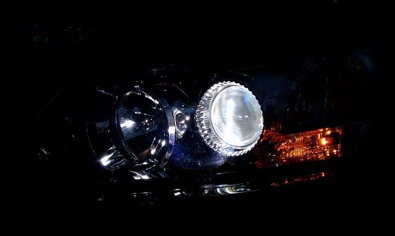

I was actually able to get my best shot using my cell phone
biglilsteve is offline

Old 01-20-2011, 12:41 PM
biglilsteve's Avatar
Join Date: Nov 2010
Location: Maryland
Posts: 2,745
Very satisfied! And there are lots of people that have gone with DDM. I checked out the tC1 forum and there are people over there that have had them for like 3 years.
And I take it you have laws up in Canada regarding headlight color? 5000k is the whitest color you can get from HID. You don't get any hints of blue until you get to 6000k.
55w is, as you might imagine, brighter than 35w. This also will help you with your color dilemma because the brighter light produced by a 55w system washes out the color more, automatically making it whiter, regardless of what temperature bulb you get.
I would say a 55w 5000k system would get you 99% pure white light. I'd consider my 55w 6000k system to be at least 90% pure white. As you can see by my latest pic, there isn't really any blue there...which I love.
The only time I see blue is when I first cut on the headlights and they first start warming up. In 15-20 seconds or so, they are at the color you see above.
