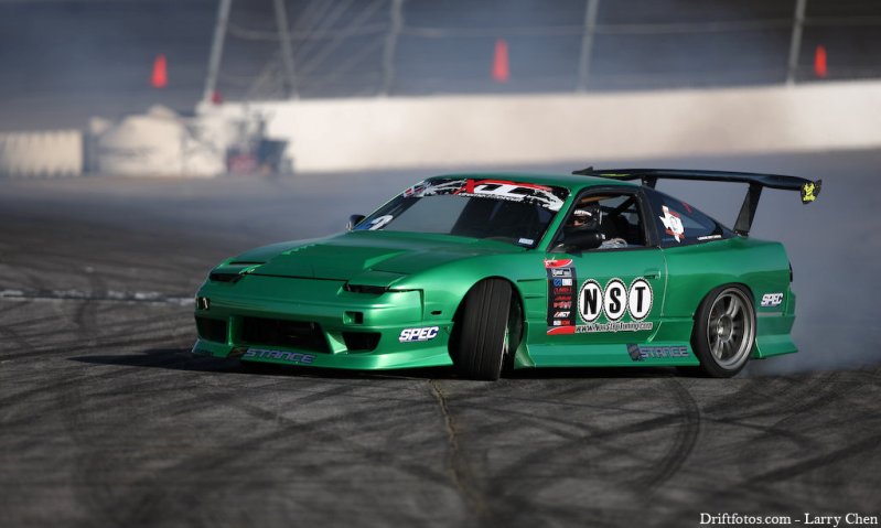

Furthermore, we have used these same pulleys on several NST race cars over the past few seasons. We use Toyota, Honda, Nissan, etc. engines in these cars and have never needed to replace any of these engines as a result of anything having to do with NST pulleys.
Many of you have seen these cars at live competitions across the US over the past several years. These cars travel the country and compete at national events on a monthly basis.
FOOTAGE ON YOUTUBE: http://youtu.be/e190Yit1_lY
MORE YOUTUBE FOOTAGE: http://youtube.com/nonstoptuning

Race teams aren't going to care about long term damage to their cars. Winning is more important than anything; if your car is worn out at the end of a season it's ok because a successful season will lead to more money from sponsors. Also, most of those are running under drive pulleys which are appropriate because these engines live at high rpms. UR pulleys also give you more gains because all the accessories run slower which leads to them using less power and storing less potential energy(inertia). I have yet to see an improvement in lap times(autox or road course) from only a lightweight pulley(PROVE ME WRONG).
Bottom line: toyota engineers(who are have lots of experience building engines) decided that it would be worth the money to put in that piece of rubber. That thing costs alot of money compared to just casting a solid pulley. Now you have to cast 2 pieces and join them with the rubber. Take the cost of that and labor, multiply by the hundreds of thousands of engines built and you get a truly gigantic number. But in this age of cost cutting for toyota where the engine cover was given the ax and interiors are decontented beyond belief the torsional damper is still there.
