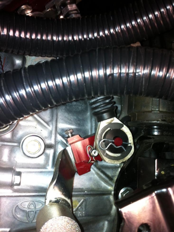

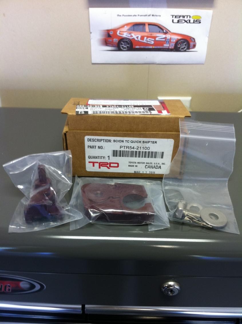

Well I finally had the chance to install it.
Installation was very easy once you take the air filter housing out and you'll see the two locations to install the extender and the quickshifter itself (see pics below). All it did was move the cable up and sideways by maybe 1 inch and that there made the BIG difference!
You'll notice it when you shift. It is for sure a shorter throw. At first I thought I was in neutral when it was actually in 1st gear. The stick shift bearly moves and took me few shifts to get aquainted. Overall... great mod, the short throw shifts is worth it.
Attached Thumbnails TRD Quickshifter-trd-q1.jpg   TRD Quickshifter-trd-q2.jpg   TRD Quickshifter-trd-q3.jpg

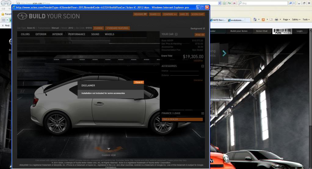

  #76
WellesleyScion's Avatar
Posts: 2,406
From: Wellesley, MA
Install is not always included on the Scion.com pricing, The website has a disclaimer on it:
