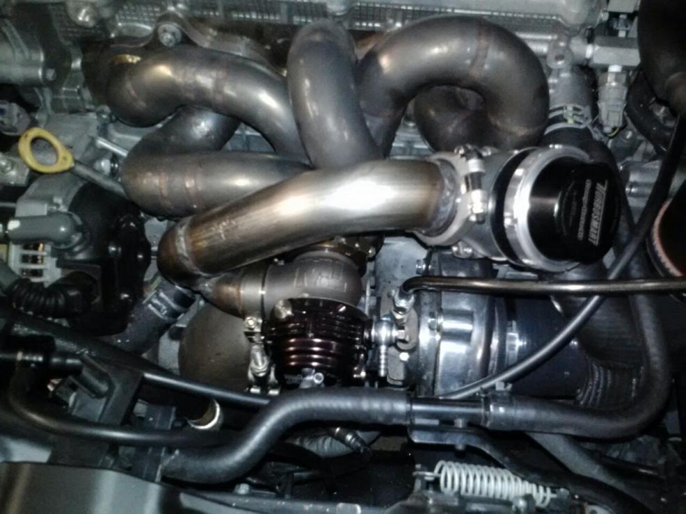

Thanks for the response. The design on the manifold shows that the wastegate does not prioritize the rear two manifold pipes. If you remove the catalytic converter, you remove tons of back-pressure, which allows the rear two manifold pipes to dump directly into the turbo. In the picture below, you'll see the DESCENDANT manifold, with the TIAL wastegate set-up. This wastegate is in the direct front of the manifold, while the dump is behind it. While I had a catalytic converter, I was holding 8.00 PSI at all times. Without it, we had trouble staying under 18 PSI with a 4 PSI wastegate spring. We fabricated a new wastegate through the CENTER of the manifold and into the dump. Fixed all of the problems, now I'm holding steady at 9.00 PSI, which is exactly where I wanted to be. This is WITHOUT a boost controller. I run a full 3" catback exhaust with a very tiny Magnaflow resonator and muffler in the far rear, along with a fabricated Cobb intake to regulate the MAF readings. I don't have boost creep issues. Just proves that removing the catalytic converter is the cause for all of the problems. NOT the BoV, NOT the intake, this was all done far before the 3" exhaust system and I was holding a steady 8 PSI.
Attached Thumbnails boost spiking!!, need help, pros are insisted to advise-photo-3-3-.jpg

Should be no excuse from any tuner to have a car stall.. at all. I just talked to the OP on the phone, but for other readers, I will just go over it. You should NOT REMOVE the CAT from your exhaust set-up or you will have boost creep issues. The catalytic converter allows you to have much-needed back-pressure for the waste-gate on the exhaust manifold. Remove the catalytic converter, and you lose your back pressure. The way the manifold-wastegate combo is designed, the wastegate will only relieve the excess exhaust from the FRONT TWO PIPES and not the REAR TWO PIPES if you remove your catalytic converter and back-pressure. The exhaust from the rear two pipes will go directly back into the turbo causing boost creeps at high RPM and gear. Major boost creep. A boost controller will not help... You have two options.
1. Add a secondary wastegate to the CENTER of the manifold to allow more exhaust to vent.
2. Reinstall your catalytic converter.
As to the stalling issues, that is going to be your MAP VOLTAGE. I will send you the map for your tuner. For me, I am always 14.7 under 3,000 RPM and when I'm out of boost.. no exceptions. Maybe 14.9, 14.5, etc. It doesn't vary, that's very dangerous.
You have my number, let me know if you have any questions. Here's my thread for further reference.
http://www.newscionxb.com/123-2nd-ge...ld-thread.html
You don't have to add a cat, or another wastegate (though that will solve it too.) If using a 3'' v band exhaust , Ptuning sells a restrictor disc which simply gets sandwiched in between the flanges.. select inner diameter (2.5'' on s pipe should do the trick ). If using a standard 2 bolt flange exhaust, bolt a smaller diameter 2 bolt flange in between existing ones. May need longer bolts.
