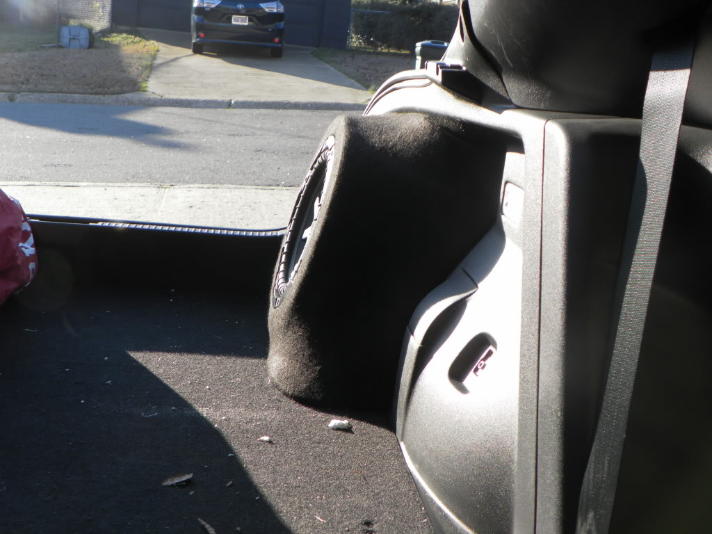

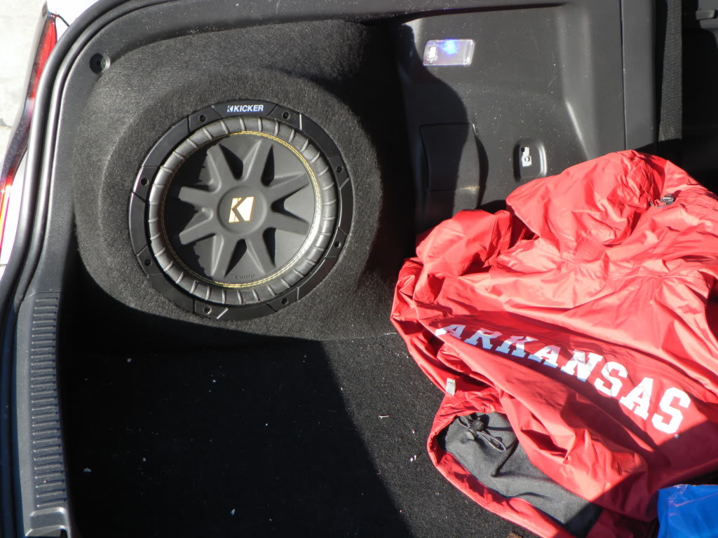

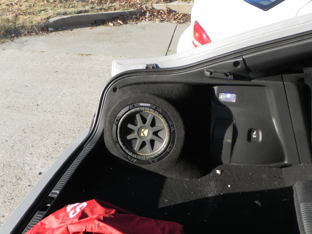

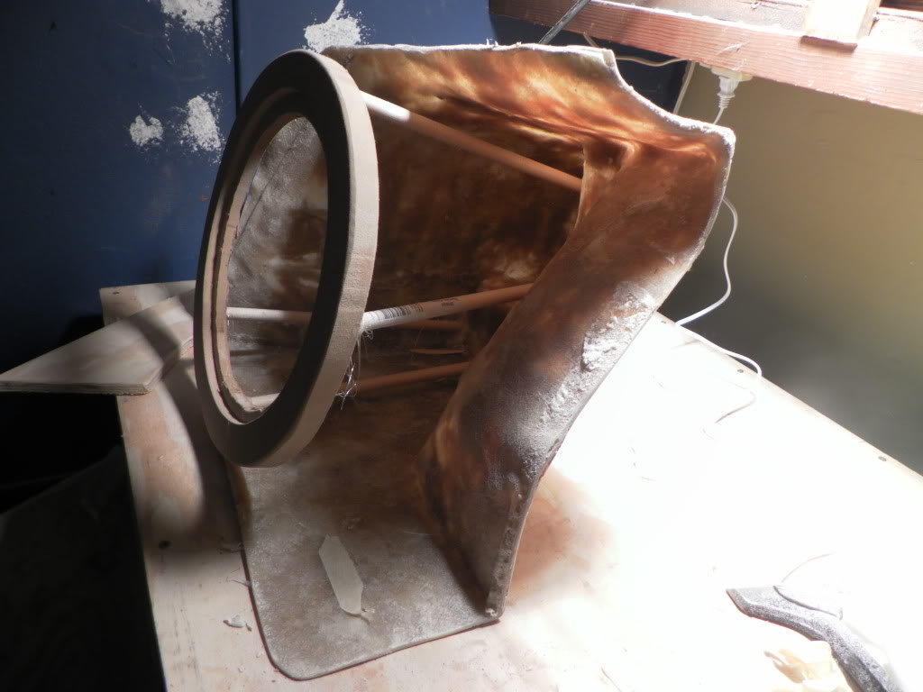

First one is done. It sounds so much better than the MDF box I had before. I was really surprised what a difference it made.
A few more production photos:
Mounted the ring of MDF using wooden dowels and "professional" strength hot glue. I made the MDF ring recessed so my sub would sit flush in the box.
I should have taken more pictures, but after working for two or so hours after I get home I'm usually pretty tired. After mounting the ring, stretch some fleece over the ring and glue it to the fiberglass back, then brush on resin and let it dry. After it's hard, layer fiberglass mat inside the box on the fleece (front) to reinforce. Once the entire box is assembled, apply plenty of body filler and then sand sand sand to get a smooth surface. Clean dust off with denatured alcohol and a tack cloth when ready to prime. I used a filler primer to make sure I had no holes or low spots in the box. After primer is applied, you guessed it, sand more. I can't stress enough how important prep work is throughout this entire project.
Sanding inside the ring, removing excess fiberglass, pre-drilling holes and more have to be done before uphosltering/painting.
Here's what we've all been waiting for :
Size:  156.3 KBName:  SAM_1367.jpg
Size:  159.5 KBName:  SAM_1371.jpg
Size:  139.9 KBName:  SAM_1372.jpg
