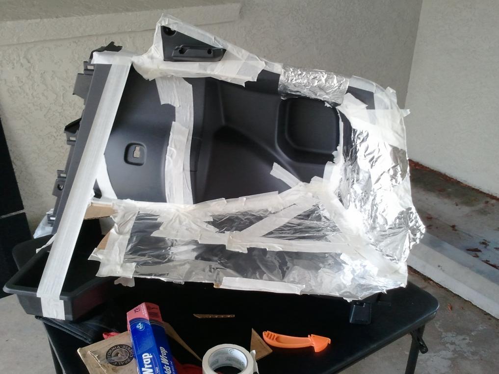

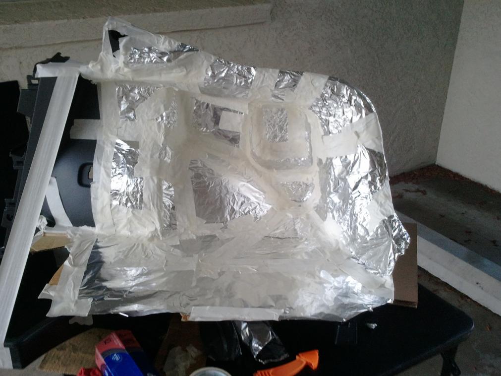

here are a few pictures of my temporary mold. i am using this to make a exterior mold so that i can reproduce an extra set for friend here.

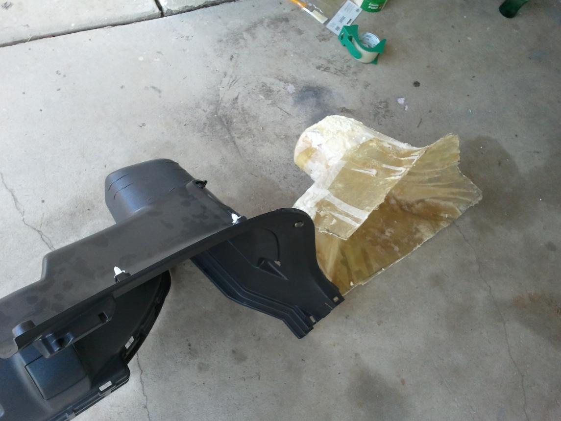

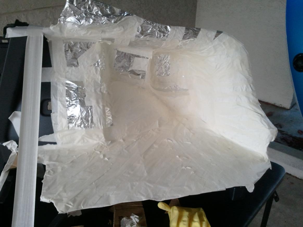

here are the others. still the inside rough mold....

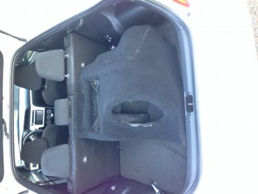

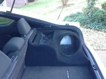

I used the same technique to build mine, but used mdf and fleece to make it bigger and ported with a spot for an amp up top. but i wasnt nearly as precise as you were. this was my first time using fiberglass.
