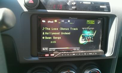

I have a Pioneer AVH-P4300dvd, and I love it! They make a dash kit to put them in, but I wasn't a huge fan of how it looked so I made my own. You also need a wiring harness to adapt factory plug to aftermarket colors to make it easier to install, and so you don't have to
tap into factory wiring / cut off plug. also need a steering wheel control interface if you want to retain them on aftermarket unit. Here's a pic of mine installed, and there's a write-up with pictures in my thread "new to Scion, proud owner of 11 tC" in the Owners Lounge.
