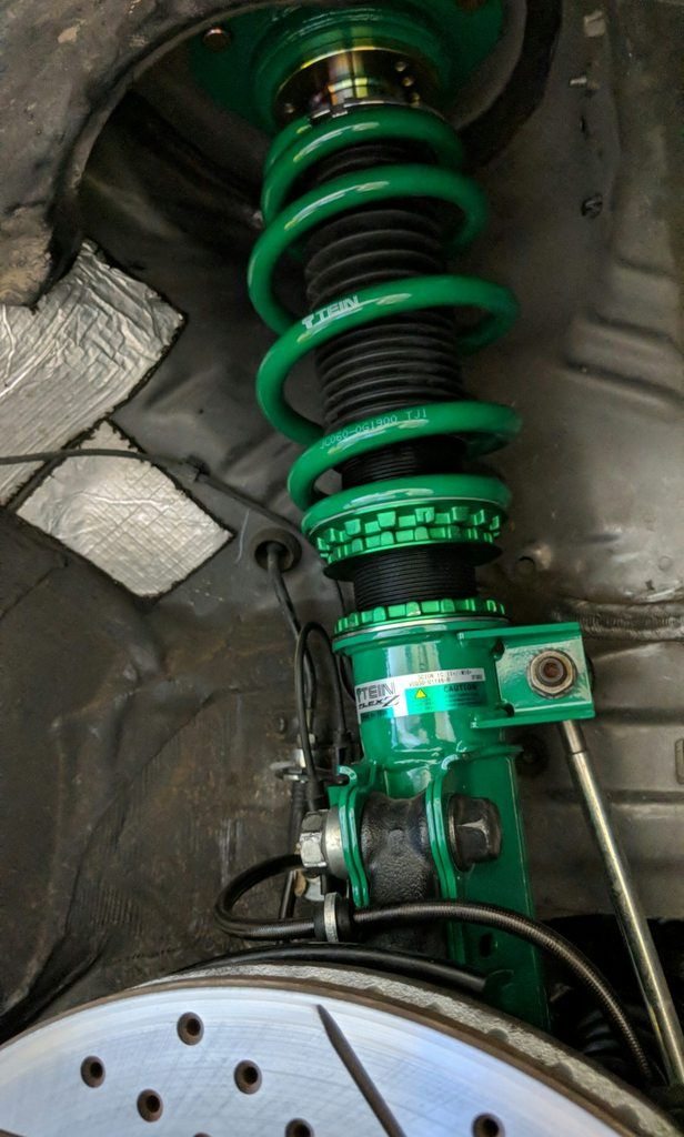

In other news I threw on the new Tein Flex Z coilovers a few weeks ago and the quality of these is insane compared to the Basis kit. The ride is also immensely better. The suspension is quiet as a mouse, much more plush and corners even tighter than the Basis. All around a solid upgrade. If anyone is debating, the Flex Z kit is absolutely worth the extra $. With the pillowball top mounts I was also able to take out a bit of camber and flush up my front fitment. Super happy with the upgrade.
Made in Japan > Made in China
Updated shots of the sexy suspension.

And so you can just basically spin that collar around and lower/raise your suspension? Is it stiff/hard? It'd be cool to have a customizable suspension.

It has an amazing ride. Much better than the Basis Z and the Ksports/Bilsteins I had on my previous car.
The Basis Z kit adjusts by moving the spring up and down, but this creates a little bit of noise the way it's designed and sacrifices ride quality the lower you go.
The Flex Z kit has a genius way to adjust the ride height that makes front adjustments simple without affecting ride quality (skip to 2:46):
The stiffness is adjustable but even at full stiff it was smoother than the Basis Z kit it replaced. Per Tein you need to run 200 miles @ full stiff during the break in to help purge nitrogen from the system that could have made its way into the shock bodies when shipping. Now I have it set to full soft (-16 clicks from full stiff) and despite being plush it still corners amazingly fast. Best suspension I've had installed hands down. It can also connect to their EDFC unit which will allow you to make dampening changes to the suspension from inside the car or automatically via gps.. but that adds an extra $600+ to the bill and really isn't necessary on the tC.

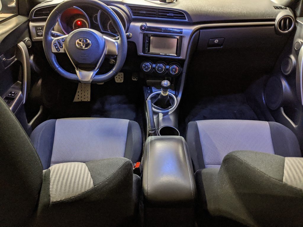

Not too much to report here as the car is /done/ aside from maintenance, but decided to finally grab the e-brake boot that matches the rest of my center console. It's nice to have that all flowing together, but I still don't think and e-brake boot is worth $60 lol. Like the shift boot when I replaced it though, this one was also ripped. The OEM vinyl is SO cheap.
That being said, here's a boring shot of the completed interior with one extra mod that you can't really see lol.
Also yanked out the front Hawk pads last night as I still want better braking from this system. Replaced them with the Power Stop Z23's and the braking was immediately improved. Ordered a set for the rear right after the test drive. This is a way nicer kit as well as it comes with all necessary hardware and is ceramic like the factory pads. So far no noise and already about 25% stronger braking. The rear set should be here Saturday and will be going on as soon as they arrive. Finally will have good brakes again!

It looks great! I like the center arm rest cover with stitched edges.

Thanks man! I've had that for 2 years or so. I did it at the same time as my shift boot and got it with the extra padding (sooooo much more comfortable than stock). Was just waiting to do the e-brake as it doesn't really stand out, but lately the vinyl has been showing its age so I decided to finally swap it over to the matching scheme and stitching pattern. I'm really happy how it turned out, and it's very subtle which I'm always into.

Did you just tape the toyota emblem onto your steering wheel? Looks pretty nice.

It's a specially made emblem for this purpose. Can find it on eBay it's for the FRS but fits this no problem. I would love a real Zelas airbag but $11 > $700 for such a small mod.
