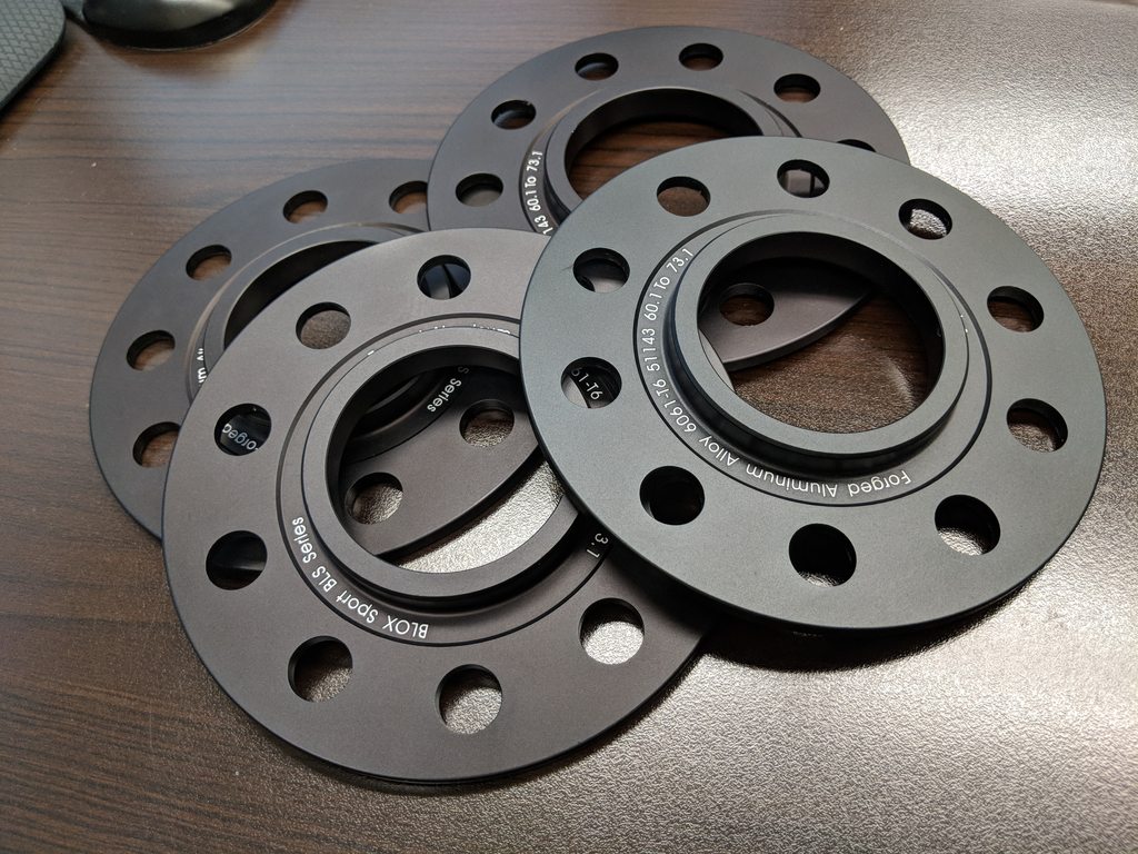

Was getting barely 6 turns on the lug nuts after swapping to the new wheels.. and my fitment needed a little dialing in.. so H&R 50mm extended lug studs and 5mm hubcentric BloxSport spacers installed this weekend. With the correct tools the install was a breeze. I am now getting 17 lug turns and the fitment is so much cleaner.
H&R 50mm vs stock 40mm:
BloxSport 60.1mm to 73.1mm 5mm spacers:
The combo

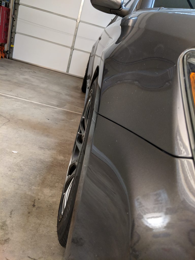

The new front fitment, might have been able to get away with a little thicker spacer but I was already rubbing on the splash shields over dips. Thought I'd be better off with a somewhat conservative spacer. It's flush enough for me, it's just the daily.

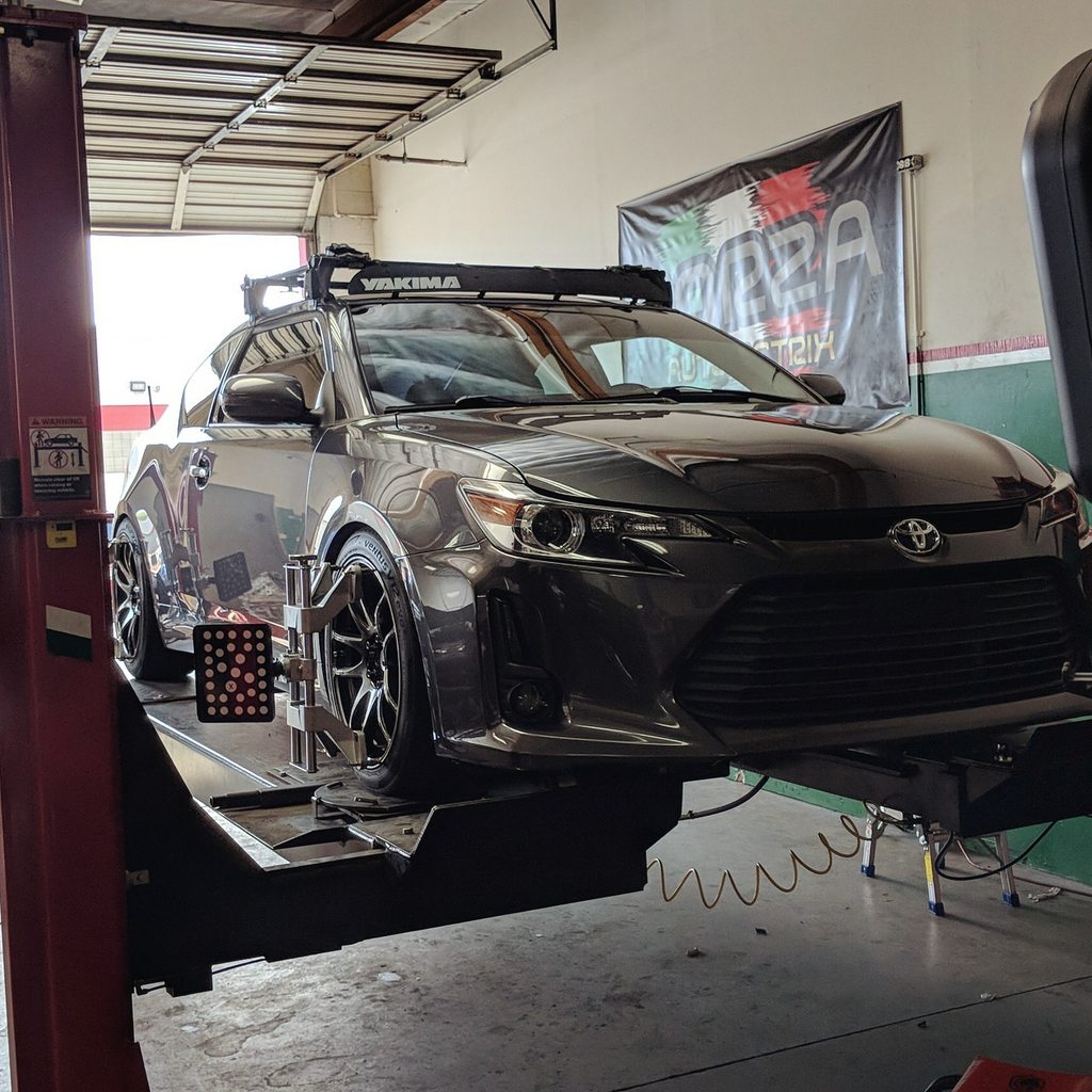

Rotated my tires this weekend and noticed the rears were wearing faster than the fronts. Guess the springs have settled a bit since I got my last alignment ~2 years ago. Half a degree of camber found its way into my rear suspension which caused the toe to be about 4x more than spec. That'll kill your tires every time. Still hard to believe the car is dropped 2" and my front camber is only -0.6° stock. Back to normal now, let's see how the v12's do from here on forward.
Looking tough on Forza Automotive's baller John Bean alignment rack with custom sensors.
