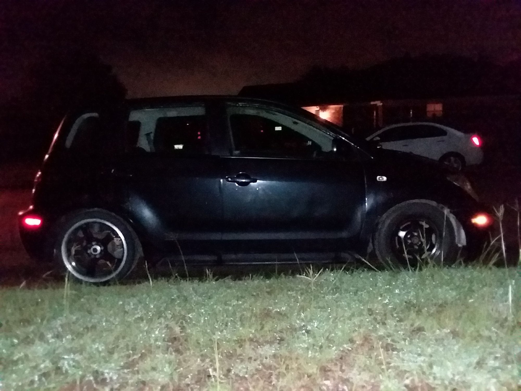

I can take pics of the wheels if you want to see them.
I am in the process of taking them off the car.
I replaced the fronts with steel rims but there are still 2 on the back until I can get 2 more matching steel rims to replace those too.

you'll need 15 inch rims 14s won't fit

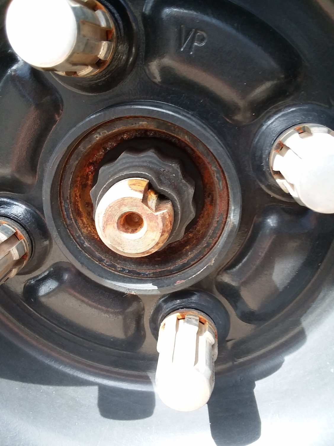

See my previous pictures.
I've been running 185-65-14 up front for several weeks. The Tire Calculator says this size is just slightly smaller than the stock 15's.
The 14 inch Chevy Prizm rims clear the front brakes, correct offset, correct hub size, correct bolt pattern.
I just picked up another 2 Prizm rims from the junkyard yesterday. Come Monday or Tuesday they will be on the rear of the car as well.
