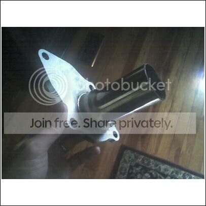

I got the exhaust flange that goes on the exhaust side of the turbo yesterday from ZPI. It was inadvertantly left out and when I called about it, they had it here to me within days. Very good response from those guys with this part.
My question is for someone with experience with the ZPI kit... Why did the pre-production kit have two bungs welded in to that piece for sensors and mine doesn't? Where do my sensors go? Here's a pic of what they sent...
I have one bung on the downpipe. So, to my knowledge I'm missing two. Any ideas? Thanks everyone!

Jason ... My flange had two bungs welded in for 1. the 2nd O2 sensor and 2. for my wideband sensor.. So on the pipe just have an O2 sensor bung welded on and a 2nd if you are putting a wide band in ( which I very much recomend). Hope this helps buddy.
Thought I would highly recommend running it after the cat if at all posible. I am still sorting out issues stemming from the o2 system. Hopefully next week I can put a new upstream in and see if that fixes anything, but my cat is still trashed. Proshop's setup was designed to be ran without a Cat, I am currently running it with one since it had to be relocated per federal emmissions.
