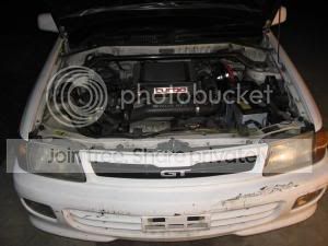

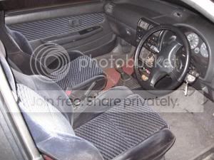

I actually have a 94 starlet, RHD, for sale in Socal...i'll post pix cuz their on my phone...but it has to go ASAP...$3000 with absolutely perfect interior and slight damage to the door but it comes with new door caps. Toms wheels are on it along with an HKS blowoff valve and an Apexi exhaust and also an intake (I believe Apexi).

Starlet for sale if anyone wants to do the swap this is the best thing to get...complete, running, and beautiful. Rapes an S2000 and keeps up with street bikes.
$3000
