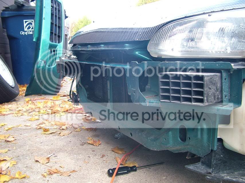

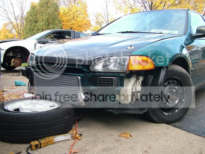

Is there any way to mount the intercooler above or slightly behind the bumper support? Not that I don't have experience with cut bumper supports, but I got a family now, and this is a family car (just want it to be fun when im alone) so it needs to be as safe as possible..
Here was my old cut support:
The crossbar is trimmed but not near as much as your Civic. I have it in a way that you keep the strongest part of the bar. You are only cutting the lower half. You could however mount the intercooler under the bar if you wanted to keep it. You would then need some sort of front lip as the intercooler would stick out under the factory bumper. You would also need 2 longer pieces of silicone coupler to make up the difference in the distance from the intercooler to the chargepipes( hope that makes sense)
