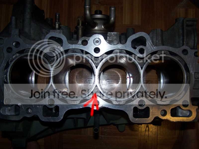

ok how about this mod to the block......a block guard
Personally I am not a fan of block guards. They aren't normally installed correctly and can put more pressure on the cylinder walls than the boost you are adding to them. Plus under high temps, they expand at a different rate than the block, and can cause the issue they were designed to prevent.
How much power do you plan on making?
The stock block will handle quite a bit of power. Rods and pistons will 90% of the time handle most peoples needs with our motors.
