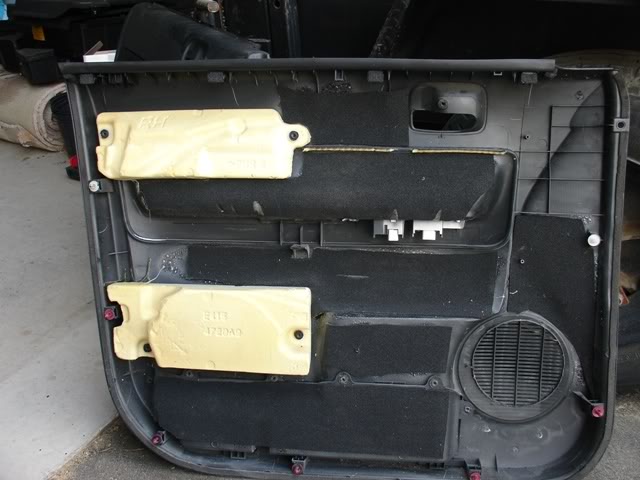

Overkill on the door panel, pretty easy

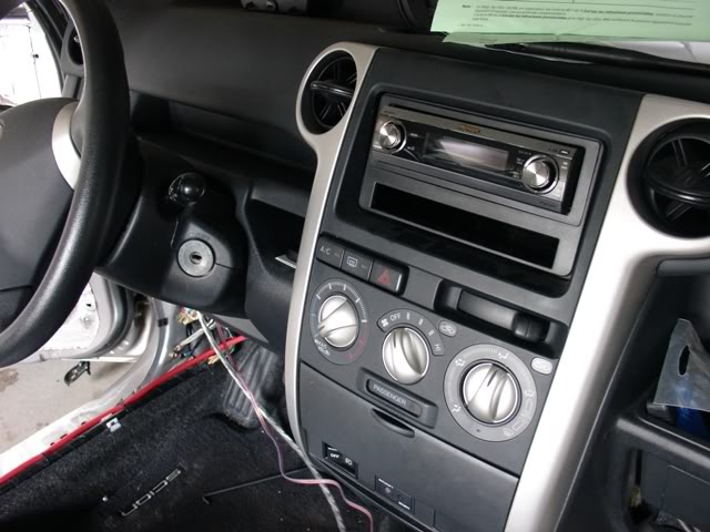

Nice and clean lookin hu

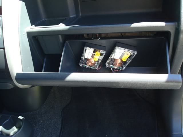

Looked for some good place to hide crossovers to make them accesible
