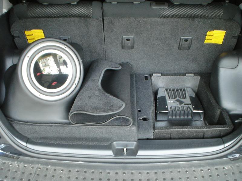

i did this quite some time ago. the enclosure has heen stolen since but the never found the amp

i did the same but took the foam stuff out and just put 2 amps. not done with my setup yet but will take pics to show ya the general idea..

i have an amp in the same location, after a couple hours playing at shows it gets SUPER hot, it is a small area and i dont know if those fans would do much to dissipate the heat, but it is pretty damm cool. im now taking the amp out of that location because i fear i might melt something important or destroy my amp.
My amp always ran hot those fans totally work great. I can after hours of play pull it up and put my hand on it without burning my hand.
The trick is to place one fan blowing air in and the other sucking air out. This creates an actual air flow rather than two fans sucking out the radiant heat. HUGE DIFFERENCE...
