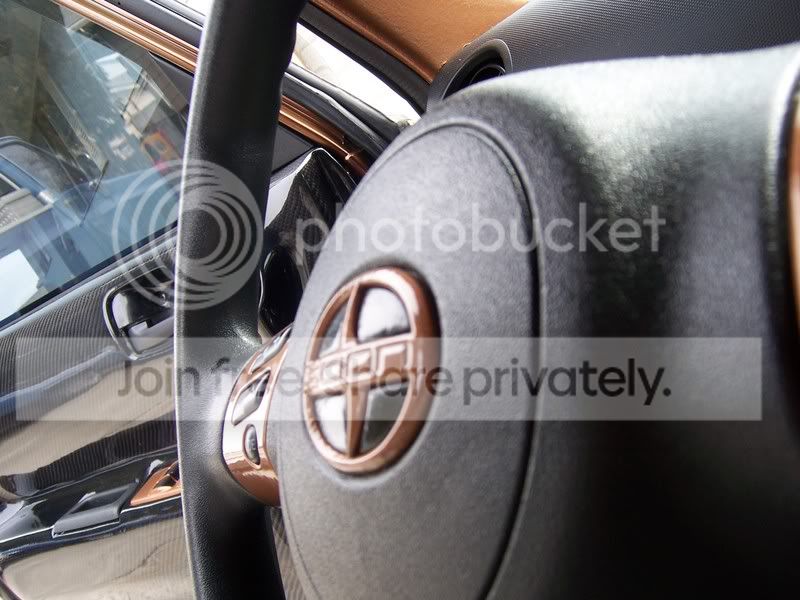

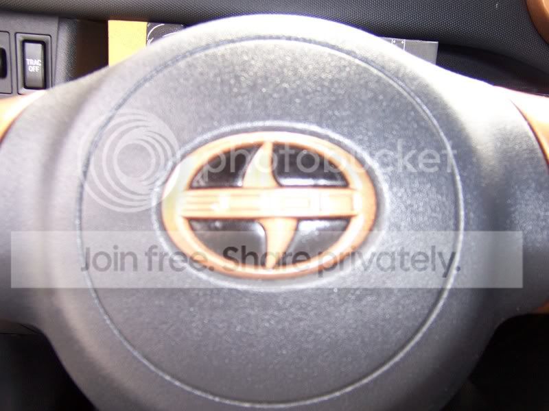

I have takin the emblem out of the airbag. it has plastic pins that go throught the cover and are plastic welded on the back.
If you just pry with a bunch of small screw drivers(being careful not to ding up the airbag cover. You can work it off.
Take your time.
The airbag cover has the scion emblem molded into it so you can't just put on a toyota emblem on.
but you could take your dremel and be very steady while triming the little lumps down and just scuff the whole area where the emblem goes and put the toy or lex emblem in there.
I used a little super glue to hold it in place.
some of them are blury. The shiny black is where I had to sand down a little from the dents from prying the emblem out.

That's the newer style airbag wheel. Mine is the 03'-early 06' xB one without the HU control buttons.

the process is still the same Jeff, I removed mine on the old style back in the day, its possible to do, as long as you are careful and take your time. It would be easier to take it off and work on it.

all logos on airbags are plastic welded into the airbag, with the exception of the metal ford logos, they are stuck through and pinned with metal tabs, so the above way is the only way to take it off, but you also need to look at it this way, are you willing to sacrifice safety for looks? superglue isn't going to hold that emblem on if you get into an accident, and have you ever seen how high an airbag will launch into the air? about 200 feet straight up, they sound like both barrels on a shotgun going off when not in a car, think about the force that that airbag is putting, and the emblem is having to go through, or once removed the superglue that holds it on
