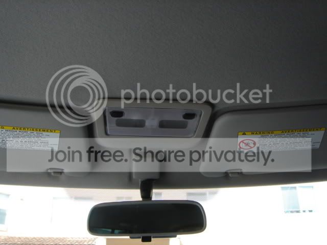

Here is what i did..put a light from a 2007 Escalade, check it out

BluBox04:
That is SO perfect! Color match to headliner, shape to fit space between visors--sweet.
I have an 05 box with a Webasto sunroof, the one with the small control panel just slightly to the rear of the visors. Exactly how does your 07 Escalade piece fit up into the headliner: does it just "float" or hang from the material? Need something solid to mount into?
Am wondering if I would have enough room in front of my sunroof control--but behind the rear-view mirror--to put in something like that. I really need map lights and/or cabin light ABOVE my head (not behind it, like with the stock dome). BTW, are there 2 map lights AND a cabin light? Any suggestions or help will be greatly appreciated, thanx.

Well it kinda floated but i put some carpet foam around it that way it will be kinda stiff, so when i push the buttons it wont move, there are 2 map lights, i only wired it that way.

Would you have a part number for me?
And cost from Cadillac dealer?
thanx BluBox04

wow blubox, thats a pretty sweet mod.

I believe Randode and Yelosub have both done map light mods near the rear view mirror. They look totally OEM............
