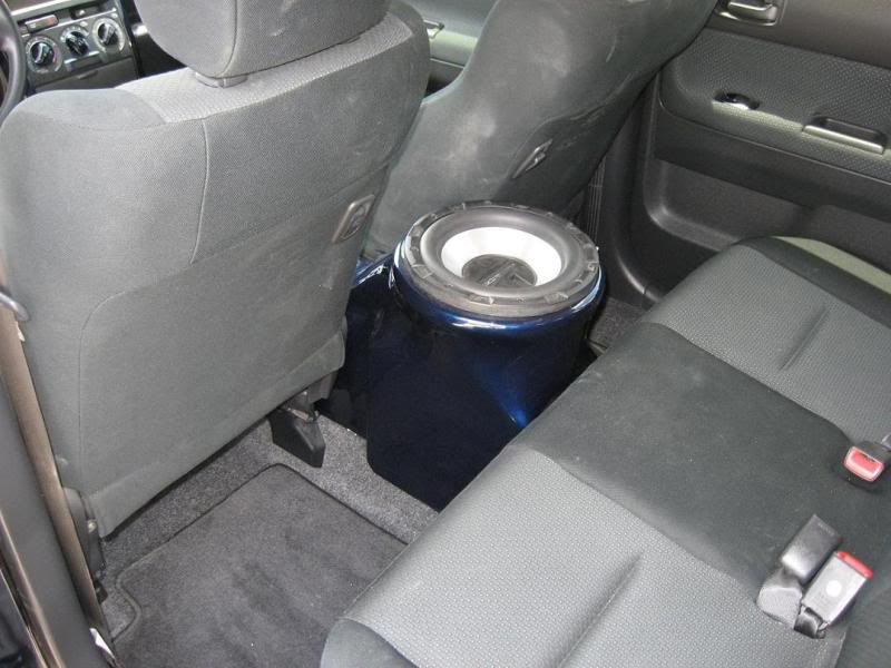

Box design has a HUGE impact on the performance of the sub. For example, a ported enclosure designed specifically for the woofer is going to be CONSIDERABLY louder than the average sealed enclosure. Unfortunately, it is also going to be much larger than the sealed enclosure, which limits its installation location possibilities.
You want to have an idea of what you are aiming for, then tailor your setup toward that goal.
For example, I built my sub setup mainly to give me the low ended, tight, quick thump associated with a kick drum as I listen mainly rock and jazz. I also have a 5 gal. air tank in the back hatch area with my amps in a false floor off to one side and I didn't want to build my sub over the top of it all. I also wanted to bring the sub as far forward as possible to keep the sound image as realistic as possible. I ended up building a sealed 10" into the back of a custom console so that the 10" sits directly behind and between the two front seats.
What I ended up with is this: (please pardon the dust. The pics were taken when the console was installed and I hadn't cleaned everything up yet)

Originally Posted by UV7
I highly agree.
Sick
and best advice....plenty of 10's outperform many 12's. You did mention you wanted SQ vs SPL is that correct and what is your budget? matching your components specs is key what amp are you going to run and what size enclosure/type do you want to use?
