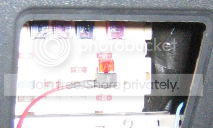

No need to go through the firewall. Just run the positive to the fuse box. Instead of pinching the wire into the fuse, use a fuse splitter. You can pick one up at your local auto-part store. I got mine at AutoZone. You will need to use a volt meter or a one of those cirecuit testers that look like a pick with a light in it to find the right wire to tap. I used the hazard spot on my xB. It always has power running to it. Here's a pic of what I am referring to. Good luck!

awesome! thanks for the pic, too! that is exactly the info i was looking for!!!
