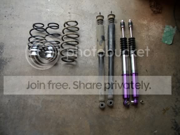

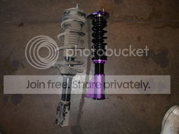

i just bought these and am working on installing tomorrow. can anyone who owns or has owned them help me out with adjusting them. ive never had coilovers or dealt with them so im oblivious when it comes down to height adjustment! thanks. --Jeremy
Old Aug 19, 2006 | 10:31 AM
  #98
WeeMan's Avatar
Posts: 650
From: Guam (the 671)

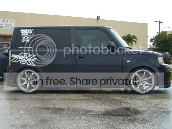

installed. here are the pics. i can adjust down 6 more inches in the front and about two more inches down in the rear. (of course doing this will cause my car to be inoperable)
my front coilover setup is pretty much adjusted all the way UP. while still having the bottom black screw base bracket thingy.
i am trying to figure out if i need this if i dont i can lift the front another 4 inches without having any troubles. id like to lift it about another half inch to an inch. same for the back setup up about an half an inch or so to be happy.
about the D2 coilovers. inorder to adjust the height in the front you ahve to remove the wheels, AND unbolt the front brakes in order to adjust them up or down. it isnt that hard to do, just a pain in the @$$ when you do it a couple of times. the rears adjust like all other coilover sets, BUT the shocks can adjust up or down to make them larger or shorter! i havent seen this before, so i got excited.
here are the pics...
front stock and D2's
rear stock and D2's
new height on cement
stock height on grass
D2's height on grass
