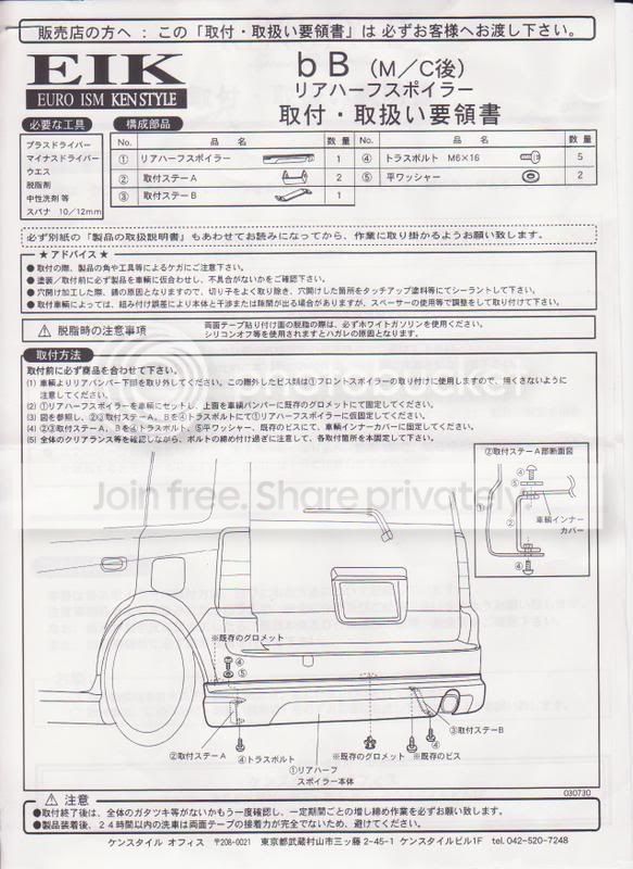

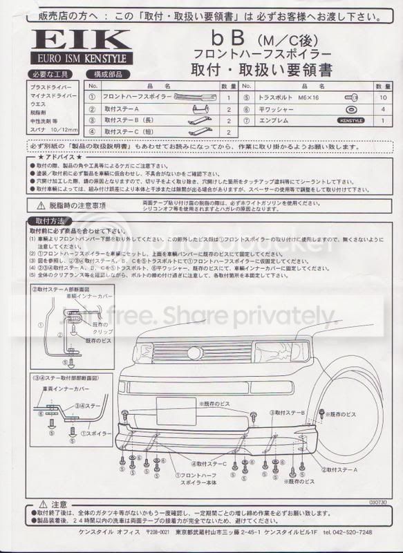

There's a guy on here somewhere who was nice enough to scan his installation instructions from kenstyle. He's selling his kit, its the real deal... ureathane (spelling?)
anyways it helped me on mine.
I forget his name.. I'll try to find it and give him the props.
You can make a decent bracket from some thick aluminum strips. I have some laying around the shop. I'll use the aluminum and bend it to the shape I need. No big deal.
I havn't done the brackets on the front yet, or the bottom brackets on the sides. I only did the rear lip bracket.
On the front and rear, you dont absolutly NEED a bracket, though it would make it more sturdy.
The front is pretty good by itself, after putting some nuts, bolts & lock washers attaching it to the bumper.
The back would need a bracket more than the front.
The sides need something fabricated to make them tight with the body towards the center of the skirt. I'm still working on that.
On the instructions the pics show some kind of angle aluminum or something with doublesided tape. I tried that, but it didnt work well. i think i'm going to glass the angle aluminum onto the side skirts, and figure out a way to sqeez some kind of tool up in there to get a fastener, maybe a self drilling screw or something. I can get by with how they are right now, but I want them to be tight against the body.

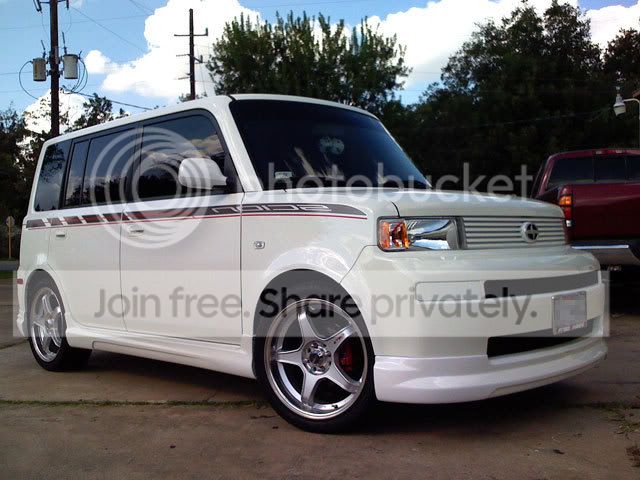

Here's mine. I just installed it last week.
My front lip looks way off on the color because I have an invisible bra on the bumper. Its yellowing, so I think i will take it off. It would helped if I washed the car too! :D
BTW you should go through the trouble of installing everything BEFORE you start on the refinishing. Its a pain if you get it all prepped and painted, and then have to do some extra work afterwards because it doesnt fit just right. Thats the joys we get from the knock off fiberglass parts.
Mine fit pretty well, I just had to do some extra grinding on the glass to make it squeeze into place.
