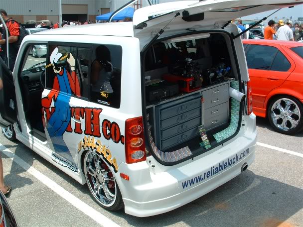

I brainstormed this for several months before buying my xB in November 2005. This is my third locksmith service van and I was tired of driving a tank (Ford E150 @ 9-12 MPG). My xB gets 26-33 MPG and is way more fun to drive (and park).
I carefully evaluated and weighed everything I need to carry. The whole deal, including myself, weighs in at 650 lbs. and with the xB rated to carry 825 lbs. she carries the weight with absolutely no problem. In fact I still fly around corners and generally cowboy around at will. Although, with a stick shift, she is no drag racer, I haven't found the hill yet that I can't climb in 5th gear.
The rear workbench seating is quite adequate in spite of the fact that I'm 6' 2'. I work back there from 10 to 60 minutes at a time on a daily basis. I can easily close and open the hatch from inside and enjoy the heat or a/c as needed.
After removing everything from the rear floor, I made a welded armature out of 1 inch steel tubing. It bolts, via welded sleeves, to the seatbelt fastenings in the floor. Another square tube runs crossways where the front of the rear seat used to be. I drilled no holes in the floor (they rust) but bolted everything down very securely to existing fastenings. The drawer units are machine screwed down to the armature.
I couldn't be more pleased by the way the conversion worked out and the way the (car?) drives and handles.

looks good and very practical. It looks like you could spend a lot of time working in there. lots of forethought and planning are obvious.

Nice fabrication and layout. Looks clean and very functional.
