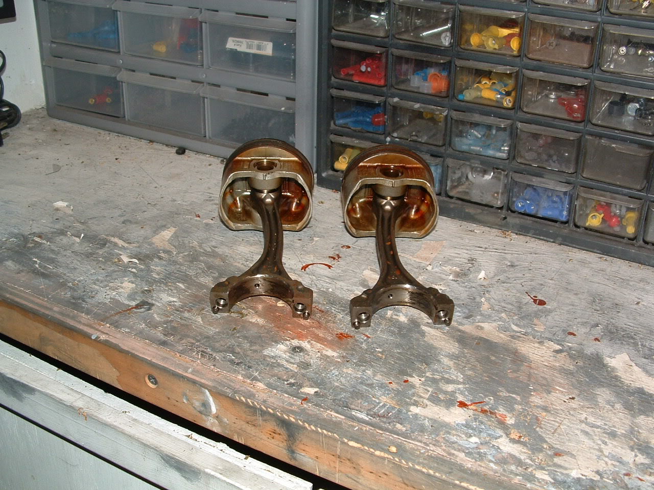

Here are the two bent rods out of that hydro locked engine:
