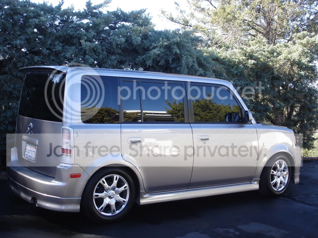

That's what I'm running now (see below). Personally I really think the slightly taller sidewall is much better suited for the profile of our cars, and as stated, the size is actually a closer fit, speedo-wise.
