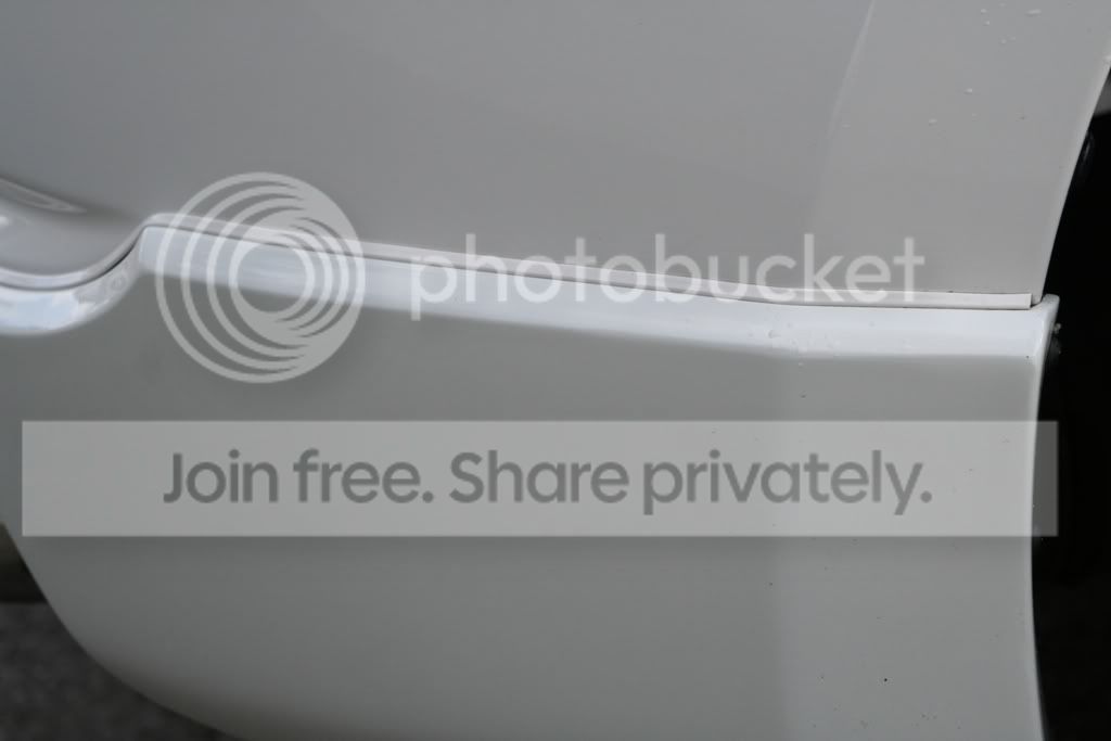

So what's everyone done to solve this issue? I have the same problem, I added the mud guard protector but didn;t not add another layer of tape to compensate so mine is also pulling away in the middle. I plan on using a couple of small screws (from the back) or some 5 minute epoxy..
Mud guard protector for cleaner look.
