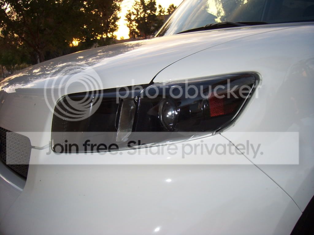

headlights baked, painted white, HID

Originally Posted by mad-sciontist
How hard was the headlight to paint? What kind of paint did you use?
Simple! Steel wool the reflective parts; and I used engine/hi temp white paint... They sell it at autozone/checker/wherever. Its the kind they put on engine parts and stuff...

Originally Posted by XD40tC
As much as I want to do this I dont want to deal with the silicone oozing out of the edges and not putting enough and overall making it look sh*tty...
You don't have to use silicone to re-seal it. Personally, I wouldn't and haven't. I threw both halves in the oven for about 10 minutes at 200 degrees F and pressed all together as soon as it came out.
I haven't had any leaking, what so ever.
I had to re do it a few times, so on a few occasions i had to buy some more silicone once I found moisture in them. I've baked them open like 8 times. haha.

Well, your not supposed to paint the reflector part. The only reflective part that bounces light in the gen2's is the high beams.... Which I didn't paint... that is unless you decide to break into the projector.... which looked way to complicated!
