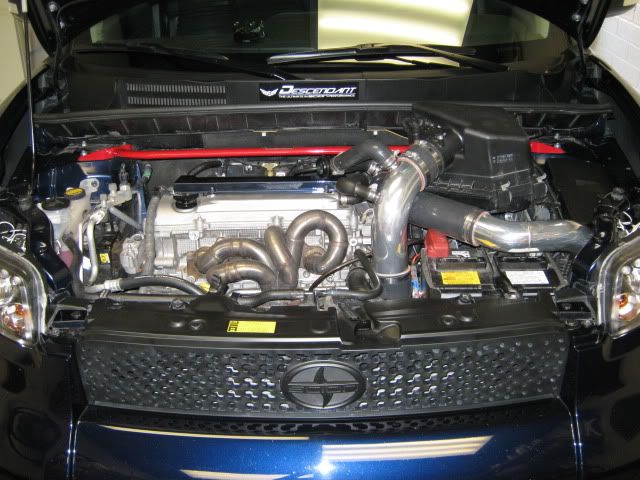

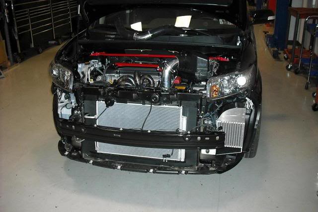

Old Aug 31, 2009 | 07:10 PM
  #52
Rob_DESCENDANT's Avatar
Joined: Feb 2009
Posts: 1,418
From: Torrance, CA / Reading, P
Originally Posted by sp2
hey can you post some pics of the side mount with bumper on thanks
Here are some pictures of the DESCENDANT Side Mount Intercooler...

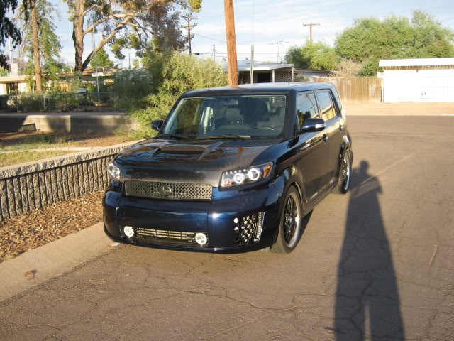

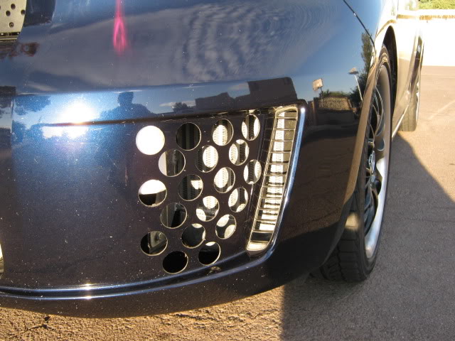

Old Sep 30, 2009 | 01:39 AM
  #53
madmarx's Avatar
Posts: 230
From: Phoenix, Arizona
New photos of the intercooler, engine bay, and gauges.
