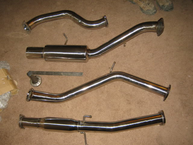

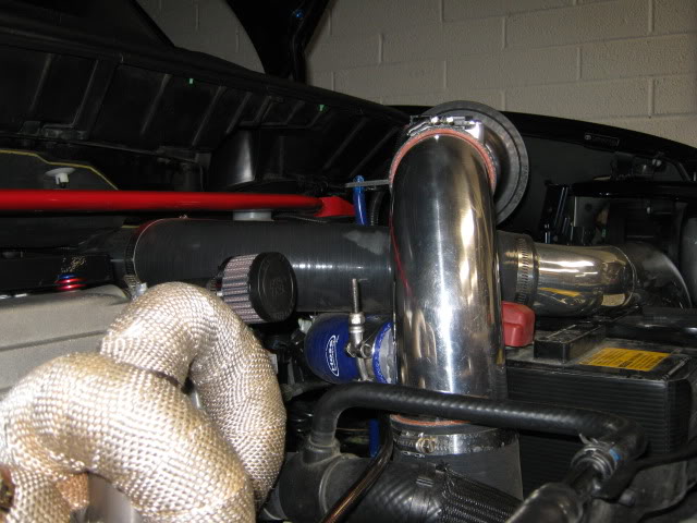

So i made some changes.
The MAF sensor holder is from a TRD CAI. I wanted to dress up the bov and keep it recirculating. The Tial reminded me of something so there i went. I installed the CXracing 3" exhaust. had to cut and splice the s-pipe in three places, but the rest of it fit just fine. After a fresh tune from Tony at UMS she put down 285whp at 6300 and 10psi.

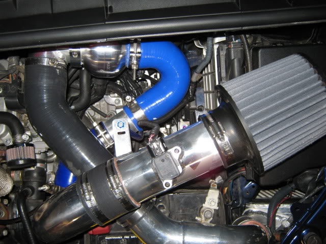

I think I finally have it, 1500 miles about 70:30 highwayity, no cel's.

Originally Posted by madmarx
Just can't stop changing things around.
You made some big changes there. Much better than the original kit. I like it a lot. I've been thinking about changing my intake pipe to the same layout you have. The CXR pipe is only 2.75" and I'd like to have 3".
Where did you get the rad hose? That's cool.

Mishimoto radiator hose. I think i got it from custom car central. $120us
