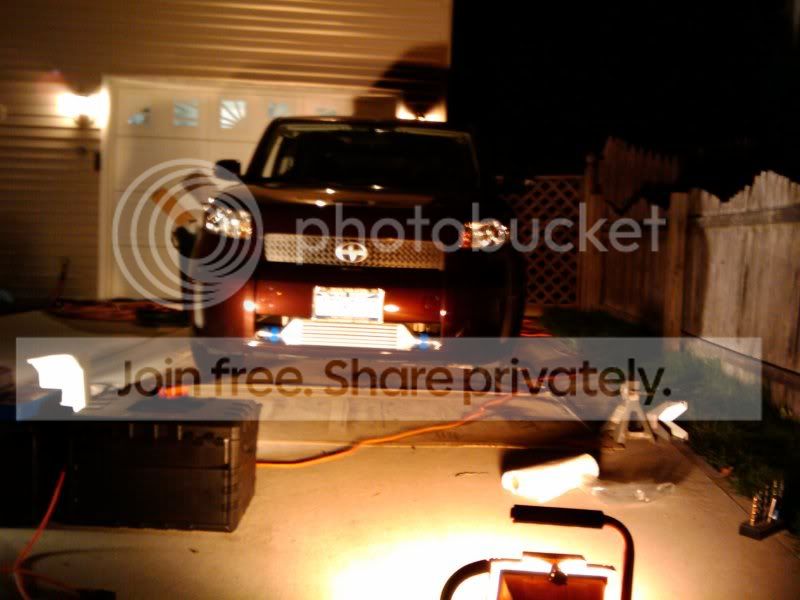

the turbo is actually a t3/t4 50 trim from my friends TC. the only things that are cxracing are the charge pipes and the intercooler which as you can see is a pretty sick front mount that fits perfectly with NO MODIFICATION TO THE BUMPER. i did not have to cut into anything to make this fit : )
Right now running 8 lbs of boost the thing definitely takes off! We had 5 people in the car plus my 300 lb sound system in the back, which might have to go soon and running just the base map tune and we were all pushed back in our seats IN AN XB!!!

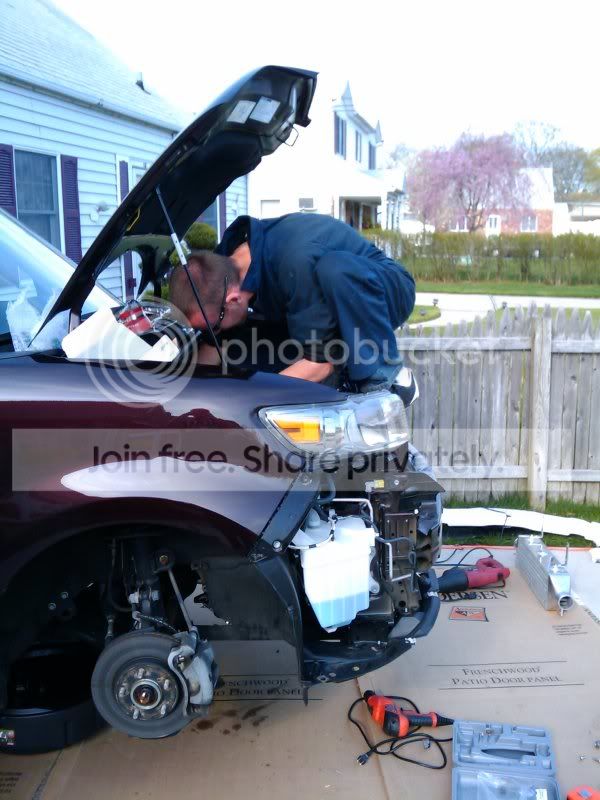

here's a shout out to my builder, blue, who dealt with a lotta crap and did a freakin awesome job
charge pipes and intercooler almost done which means whole thing almost done
stock bumper still fits right in
