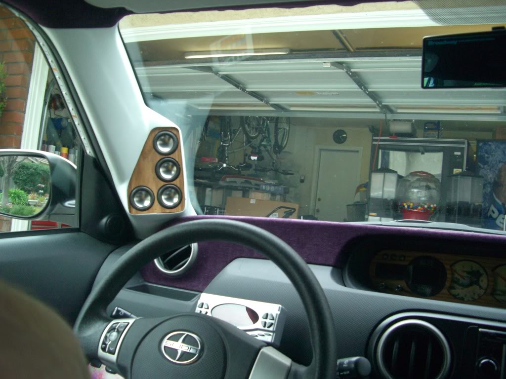

Most recent update.
I finally got the full range speakers in last week.
Left
Right
Through the windseild

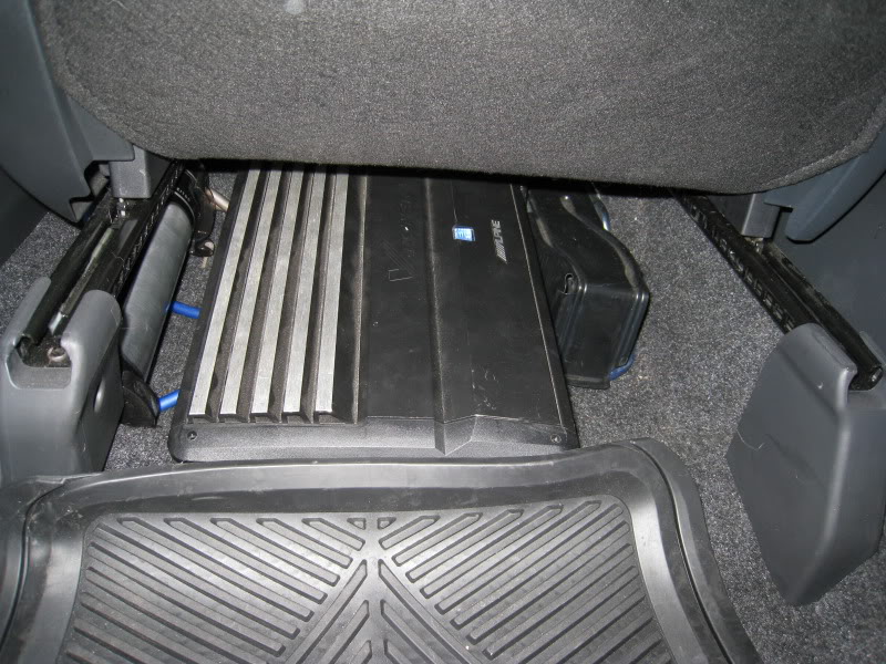

Ok so I finally got around to building my box and installing my amp. Nothing special but its better than nothing. So here goes..
AVIC-F700BT w/ipod cable

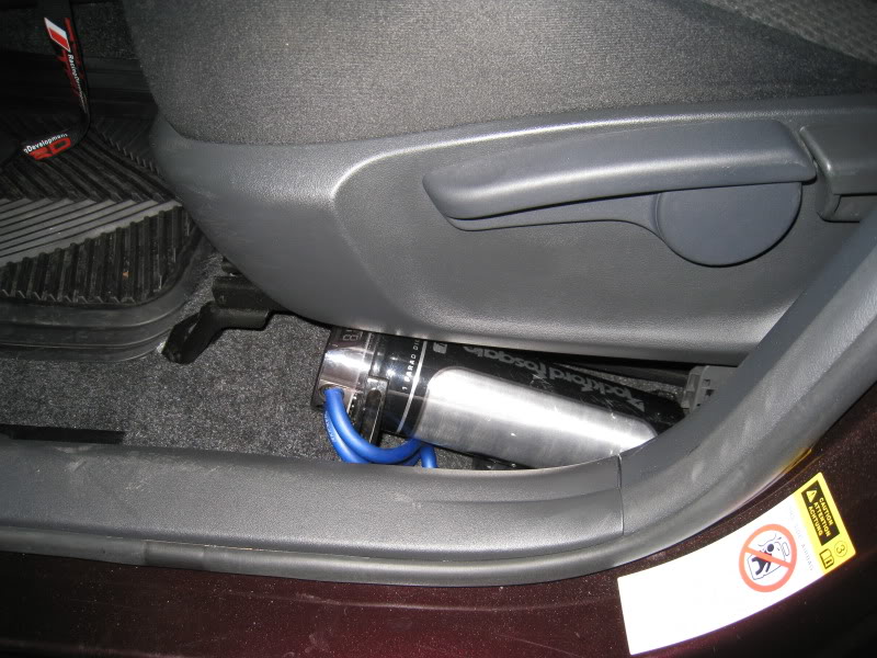

Alpine MRP-850
Rockford Fosgate 1 Farad Cap

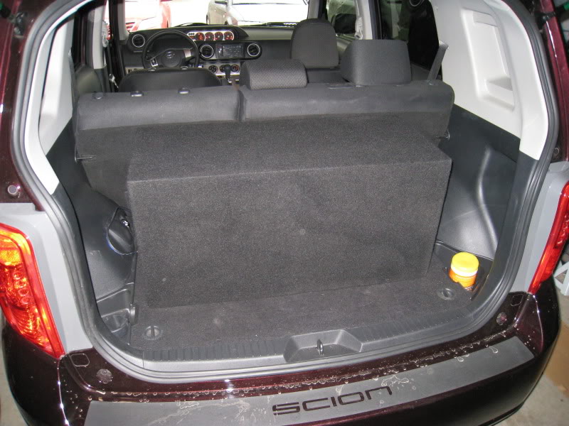

Alpine Type-R 12" Front
Back of box
I need to do some work on the box I'm not really happy with how it sounds, low frequencies are rediculous but the mids are lacking, I will probably mess with it in a few more weeks when I have some time.

What do you have in your system, UrDone? And what model Alpine sub are you using (just wondering since the box looks huge for a single 12").

alpine type-r 12" dvc wired to 2 ohms on a mrp-m850, ya the box was 7 inches too wide, i messed up somewhere in my calculations. i put a filler piece inside today to bring it down to about 1.6cu ft. for some reason i built it to 2.2cu ft. but it sounds killer now. if i had more carpet i would take it apart and cut it down. this is just a temporary build until i have the money to build up how i want it.
the whole setup is just stuff i had laying around and i had extra mdf leftover from the entertainment center i built for my parents new home theater system i set them up with.
