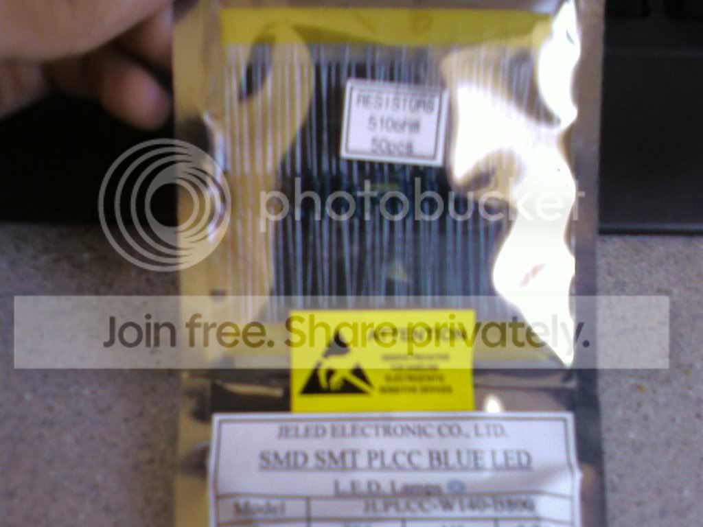

That HKJE LED lamp center place gave me 50 - 510 Ohm Resistors instead of my LEDS!

mauiGideon: are you sure you didnt get them?? Shoewbox thought the same thing too, but on closer look, they were in there.. very small....... a strip about3/16"tall & about 2 " long..... black w/white spots (the leds).....
hhhhhhhhmmmmmmmmm good luck with them! (HKJE)...

Ahh I see them now... they are in that little bottom packet.. I guess Resistors come free? lol
