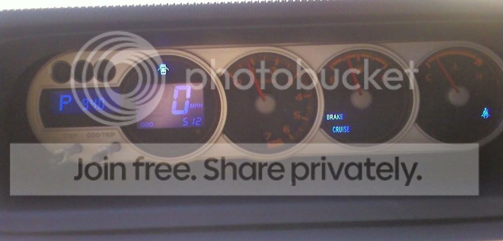

Wallaa! I also did both blinker sides and he hi light... But I forgot 2 turn those on Now I just need my custom gaugeplate from jason!
Also I wanna see ur pic with the blue needles... How'd they turn out?

well they are not blue but it doesn't make a red hue around like if i kept the orginal ones in. im thikning i may go back and turn on those guage signles on the 4th gauge to blue (mostly warning light things )

TADA??!!

IM REALLY BAD at the cutting with the exacto knife thing and i gotta get a new one. I have a backup gauge face. so imma do it again. (fingerprints EVERYwhere) and putting the stock faceplate just made it all dark and nothing shows up.
