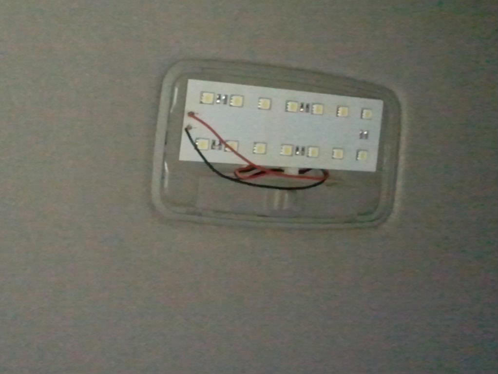

STEP 4: Plug in LED light and install.
  • plug the LED light in and test it before you peel the back and stick it in place. BE CAREFUL with the wires, the wires might come free from the solder.
  • with the LED working properly, peel the tape off the back and stick the light into place as shown:
  • Press firmly to make sure it is secure.

STEP 5: Tuck wires and recheck light.
  • I tucked the wires up into the bulb housing.
Here's how I did it:
  • don't worry about the wire going over the light. It doesn't show when the cover is back on.

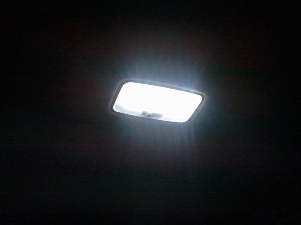

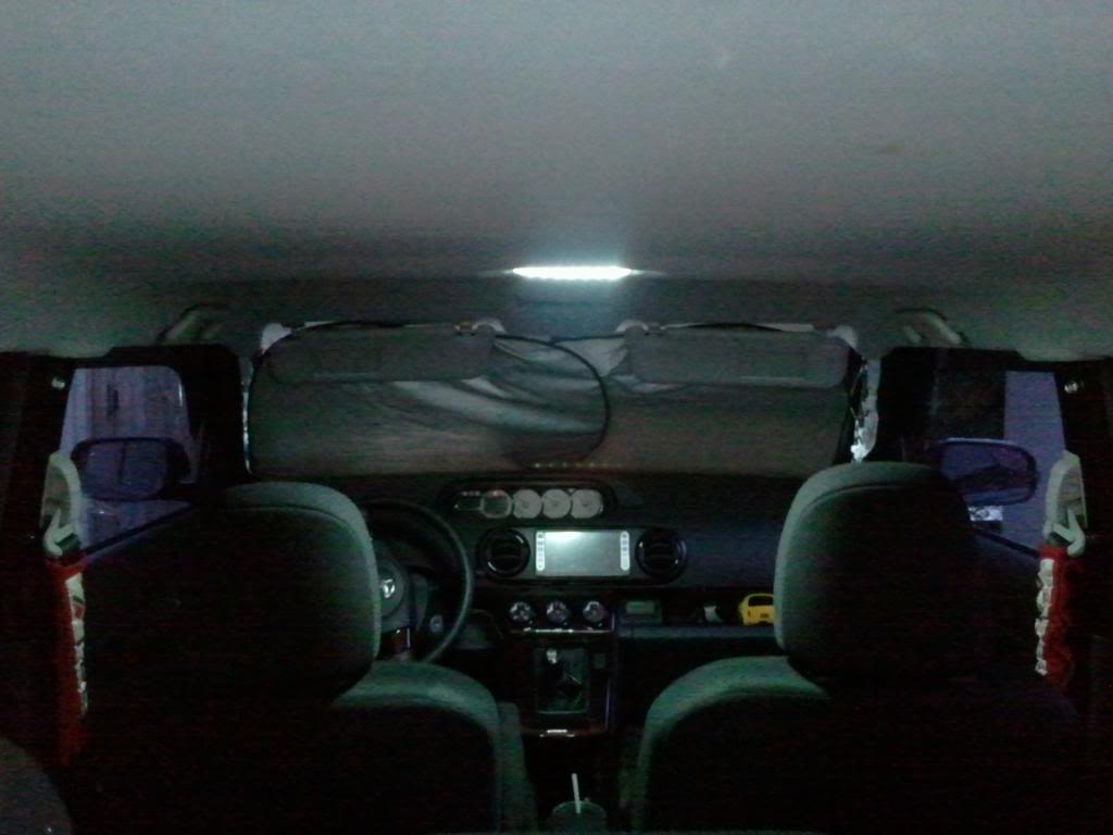

That's it. ALL DONE!!! These LEDs will AMAZE you. The extra lighting is wonderful for finding things at night, or giving the little ones in the back seat the ability to see when buckling up. Whatever the use. This is a MUST for ALL vehicles.
