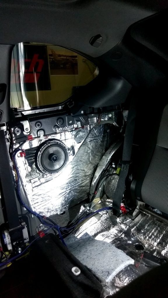

Pic of inside the door? Those are the ones I used for my tC2 and most Toyota products use them in the rear.
Generally you will have to cut off the extra tabs you do not use so the speaker will fit nicely in the bracket.
Pics on my tC2 - First pic is bracket after extra tabs were cutoff + sound deadener and second is after installed on the vehicle. Hope it helps.

I recently installed a pair with the same brackets. You have to use a drill and drill out the rivets holding in the old speakers. That will expose 3 holes once you're done that should line up with the exterior holes of the bracket. You're gonna have extra flanges that you just break off.
Depending on the speaker you get, the holes on the bracket might not line up perfectly. I just had to line it up as good as it would save drill straight through the plastic. Still holding up good.
