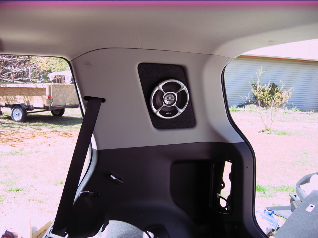

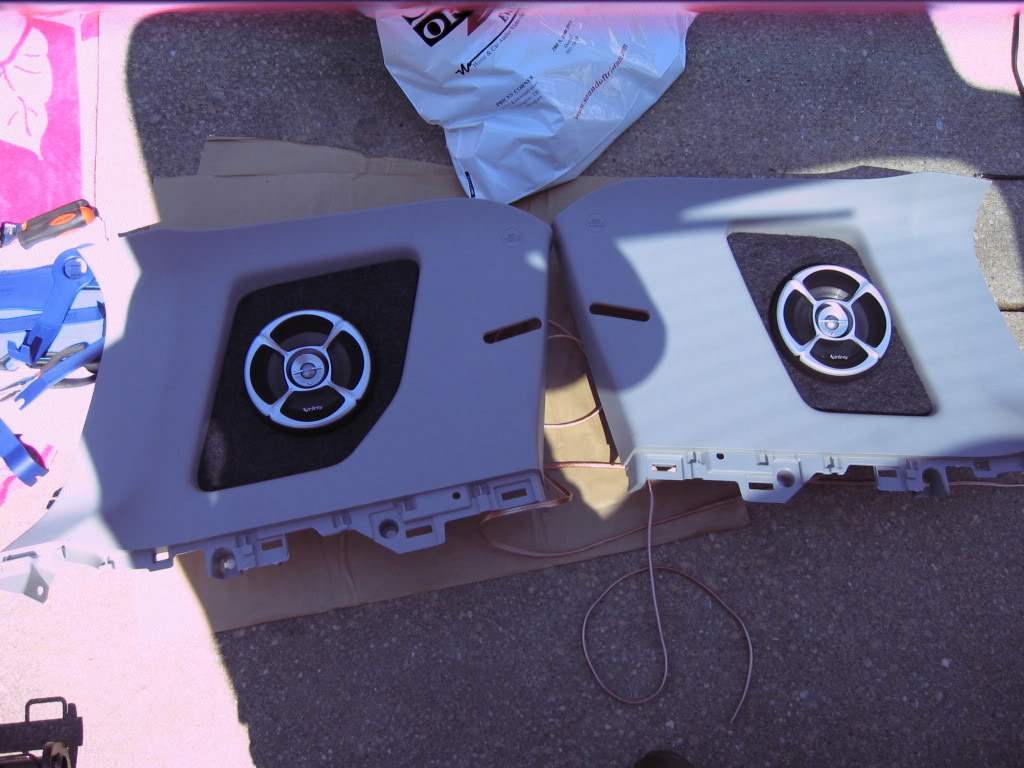

First, I upgraded the mids and highs so I could hear them over the bass. My RS5 came with the premium HU which I wanted to keep because of the steering wheel controls so I picked some speakers that matched the rating on my Sony Amp. I went with infinities both front and rear. And when I say rear, I ditched the rear door speakers and installed them in the c-pillars.

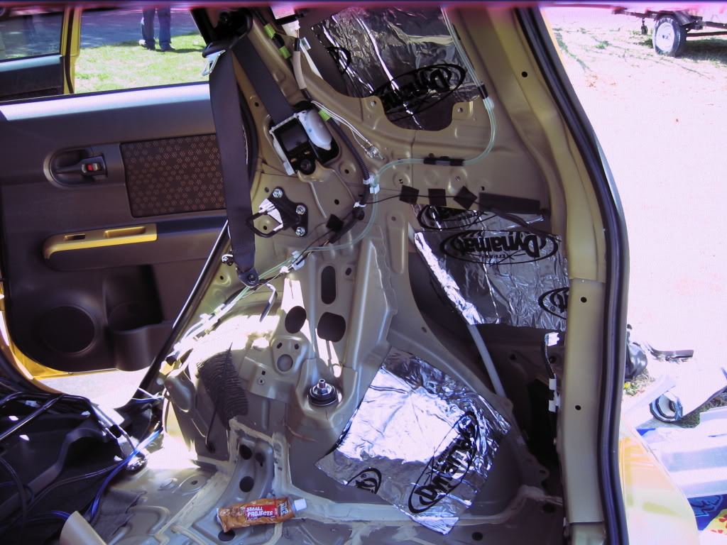

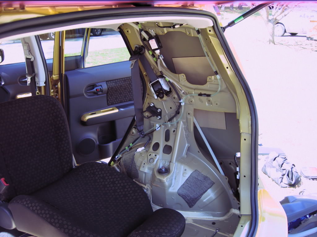

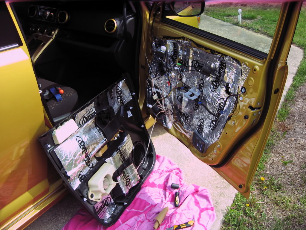

First I yanked out the interior so I could dynamat everything

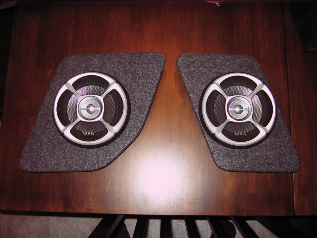

Then I made a template for the c-pillar insets out of paper. I used this to cut out wood speaker surrounds.

Then I drilled a hole in the c-pillar pieces to pull the speaker wire through and glued them in using Liquid Nails

I also dynamated the doors and installed those speakers.

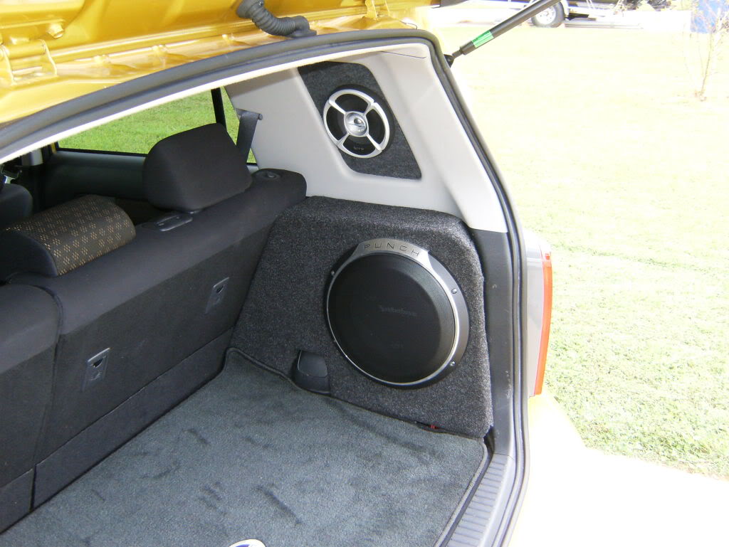

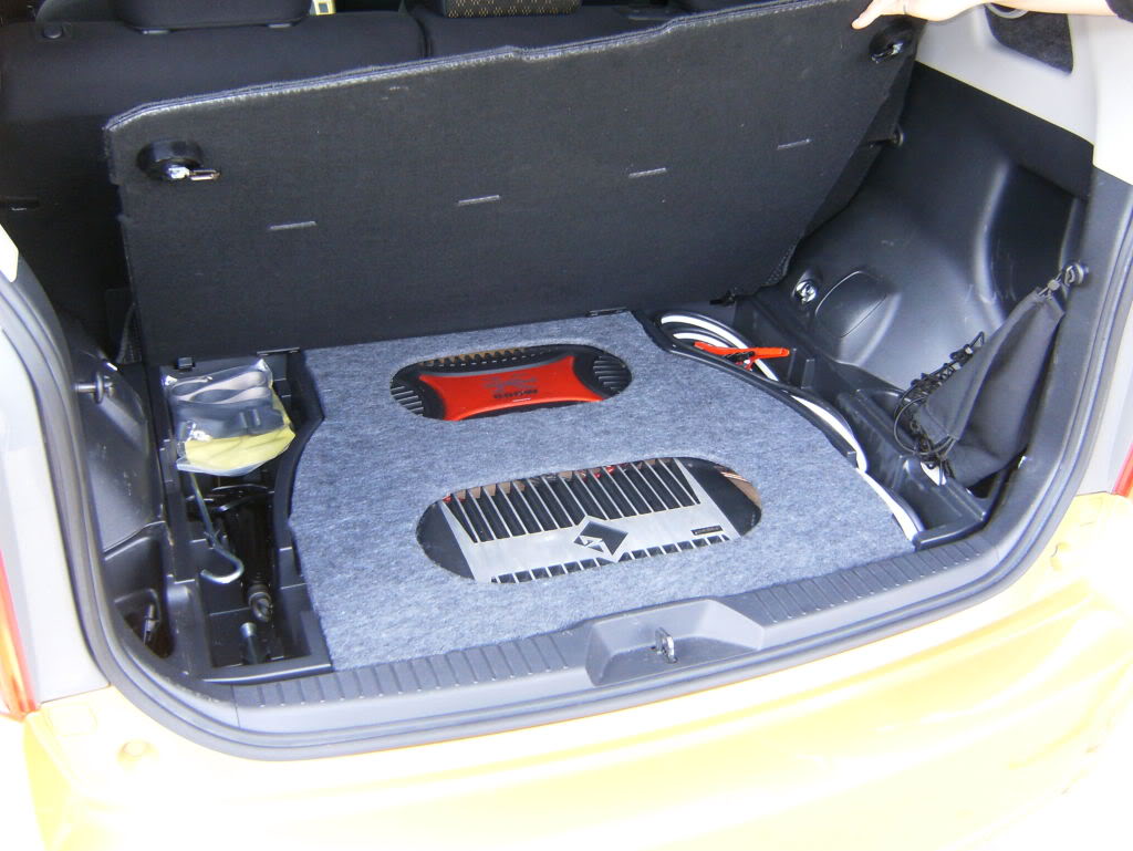

I ran all the wiring back to the spare tire area where I wanted the amps.
Next I made a rack for my amps and cap and then made a cover.
I also had to custom make the sub box. I followed this tutorial exactly:

I'm really happy with the way it turned out. The bass sounds fantastic. No rattling at all. If you have any questions just post and I will respond.

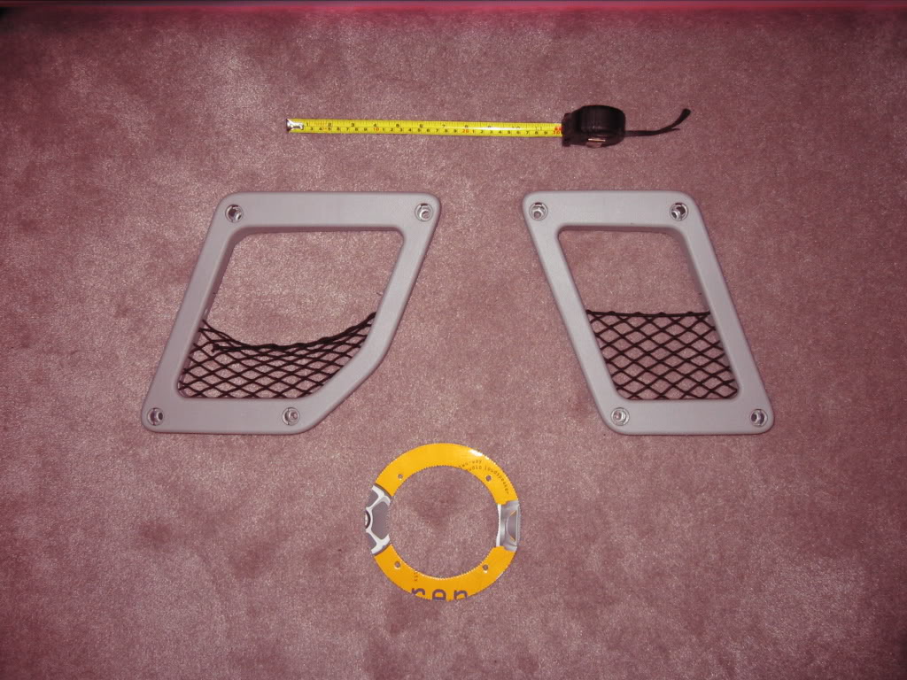

I still have the templates but I'm not sure how you could recreate them from measurements. Each corner has a different radius of curvature. I had the cargo net c-pillar accessories installed so I took those out and traced them. I could take a picture of the templates with a ruler in the picture so you could print them one to one if you want.
