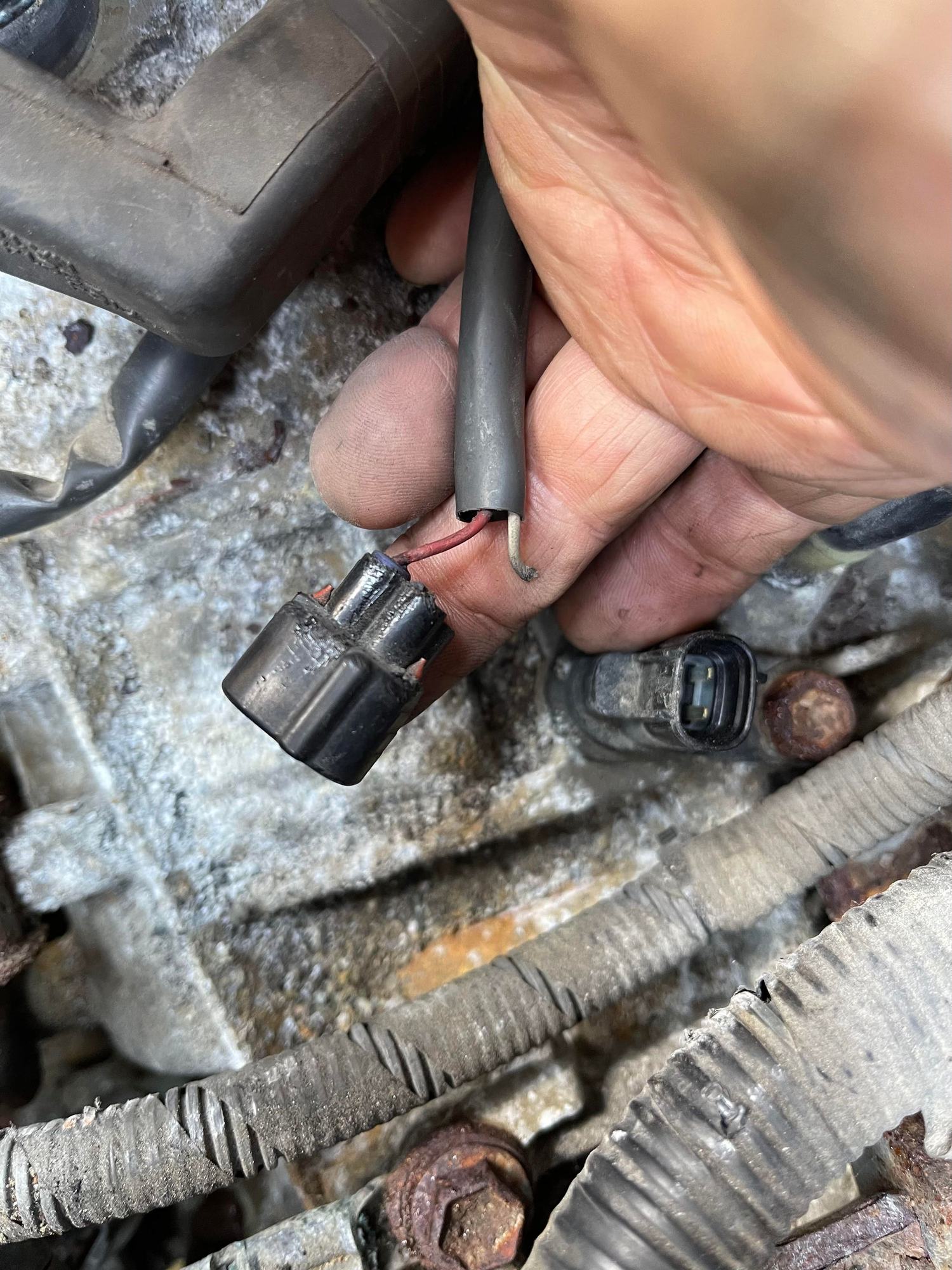

I removed the starter and discovered this below it. Any idea what it belongs to? xB 2008

Perhaps a crank sensor or oil sensor wire.

From the location I'd say it's the transmission speed sensor.
Here's a video on replacing it, but all you need to do is swing by the dealer and pickup/order the plug to replace it.
