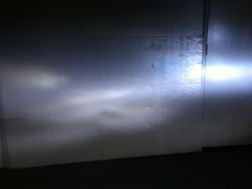

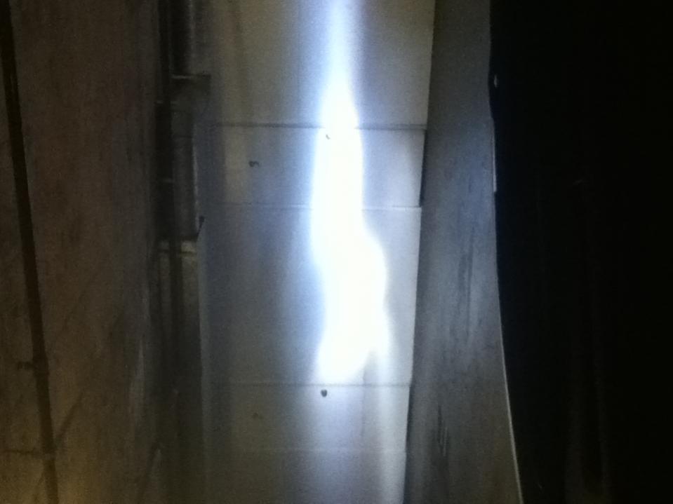

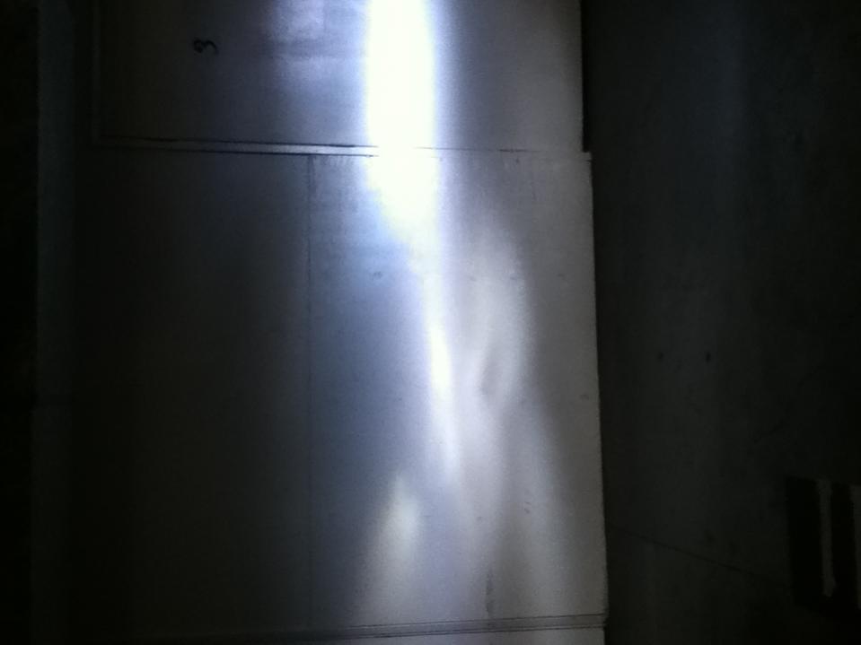

Hello there fellow scion xD owners! As you can see from the title, I have a couple of problems with my HIDs. I bought my 8000k Bi-Xenon HIDs from www.hidsrus.com
The problem I have is that:
1. My driver side light is scattered. I'm not sure if it's the bulb that's defective or my headlamps but I have never removed my headlamps at all, nor do i recall messing around with the headlamps.
2. The driver side is lighter than the passenger side. It doesn't show much of a difference in camera, but you could see a little lighter color of blue on the left side than the right side.
I attached a couple of pics for you guys to see. Hope it helps!
Attached Thumbnails A problem with the HIDs! Help!-img_0660.jpg   A problem with the HIDs! Help!-img_0664.jpg   A problem with the HIDs! Help!-img_0665.jpg   A problem with the HIDs! Help!-img_0666.jpg

Not sure if you have projectors in your headlights. As I have a scion tc.
But, if you do... most projector headlights have a cut off... so the driver's side headlight does not blind oncoming traffic. This is a safety issue. So they won't look identical... Headlights usually have a screw on the back, that gives you some adjustability, as far as up and down movement of the bulb, if i'm not mistaken.

apparently with our car when you put hids in you tend to get the "scattered" look. fro what iv read if you take off the little metal shield looking thing on your hid bulb its supposed to help not look so scattered

Go back to stock bulbs, these "BIXENON" bulbs are NOT made for halogen headlamps. You should invest in halogen bulbs MADE FOR halogen lamps.
Or get aftermarket projector headlights...and get worse output. Google "truth about HIDs" plz.

1. in our housings, HIDs will scatter, as we have no projectors. nothing really to do about it. you can adjust them via the white screws on top of the housings to make them roughly where you would like.
2. that seems like a manufacturer fail to me. temps could be off slightly to change the color.

Ah.. I see. T_T Well thanks for the help guys, i appreciate it! I guess i'll just put up with the scattering. But i'm going to ask for a replacement bulb for the color change since i really mind having two different colored headlights. O_o haha. thanks guys!

Wow honestly that looks more like a bulb issue than a housing issue... Our housings are actually pretty decent. When I did HIDs in my wife's xD there wasn't any scatter. Maybe I got lucky...

got mine from mod express and they are pretty scattered as well. i think you got lucky lol.

Mines are scattered too....took me a while to make them look even from far...but you gotta play with the white screw on top/back of the housing untill you get a good projection...do it at nigjt agaisst a wall and a place that is dark...thats the best....and about removing the piece of metal in front of tje bulb...i heard it helps to have a better and more even projection, but i havent reied it...wich i was wondering if anyone here have ever removed the metal and how does it look?
