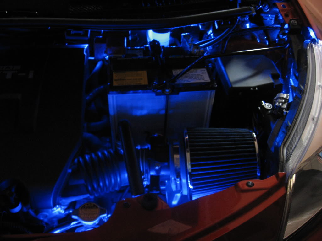

Thanks for this thread...Just did mine last night...Got it installed and mounted so it does not move around...What a piece of cake...Best $30 spent...

Looks good Sub. What are those lights there? They interest me as I have blue neons on the interior of my xD

Thanks...They are cold cathodes from randode.com
