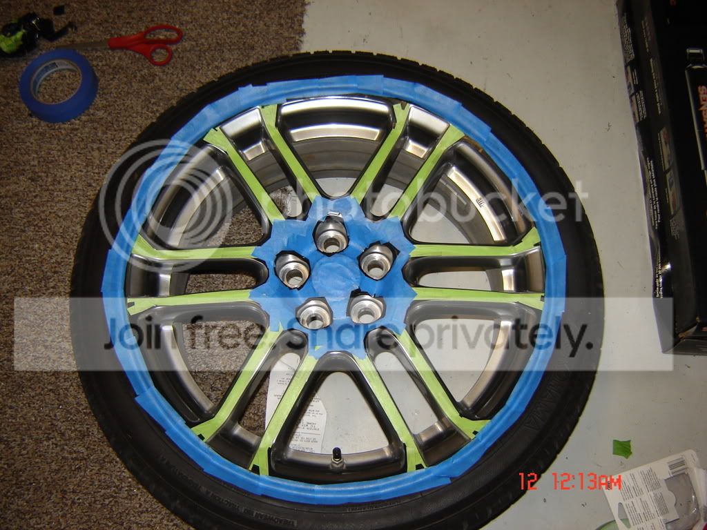

I did mine last weekend. Duplicolor Wheel Paint Flat black.
Took me forever to mask. I used electrical tape around edges and it worked like a charm.
It looks alright from a distance but if you get to close and really really look then you can see paint quality and its not perfect. It was alright until i started messing with clear coat. It feels like a sandaper in some places. Any advice how to use clear coat or get rid of that sandpaper effect? Polish wheels really goood maybe?

alucas8892 , go for it if you're not afraid to endup with completely black rims j/k Just make sure you got 2 days off to do that. Take your time. It takes about 1.5-2.5 hours just to tape everything around. I started at 2pm saturday and finished around 6am Sunday. Just remember electrical tape and acetone are your friends. After you put your last coat give it 10 minutes (dont let it dry too much), take mask off and start cleaning all that extra paint around edges with acetone just be careful. Good luck.
